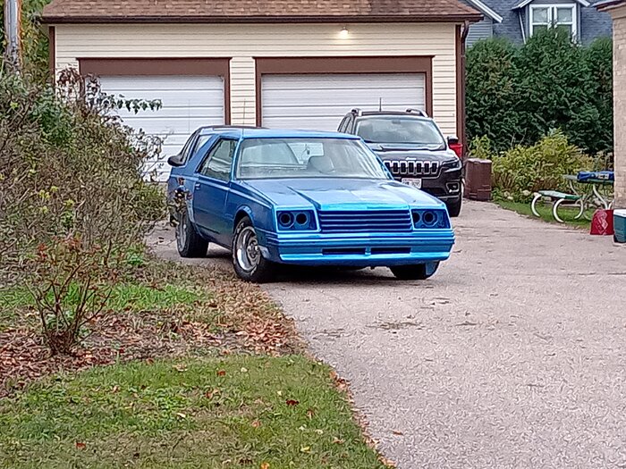

Really great craftsmanship all the way through and inspiring to watch. I don't think I've ever seen a Mirada anywhere in that color (sort of B5 blue) or even close. Very sharp.
Ele115
Apr 24, 2019
720
301
Tampa FL
It could be. Depending on the computer, and the camera or phone that took the pic, it's pretty close to me. I did a Super Bee in Ford Ranger blue and it was awfully close. I had the paint and it was good enough for a relative wanting to save some money

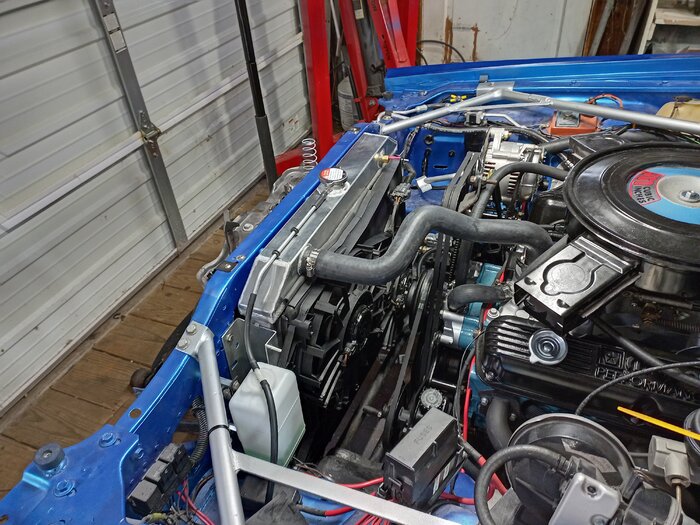

So, huge delay, my lifters collapsed. Got some Hi-Performance replacements from a good US source, even made in USA. The good news is it is possible to replace the roller lifters in a magnum without pulling the heads off, but it is a pain in the ass. Runs a lot better now, road testing to come soon.
80mirada
Sep 3, 2012
1,618
653
Wisconsin, Fort Atkinson
They had 250,000 miles of questionable maintenance, and were put against a cam with a lot more lift than stock. They were pretty sticky to begin with, and the big cam just finished them off.
