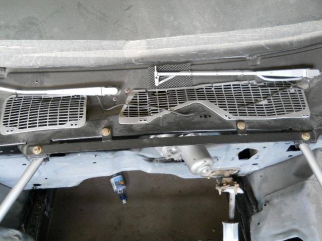

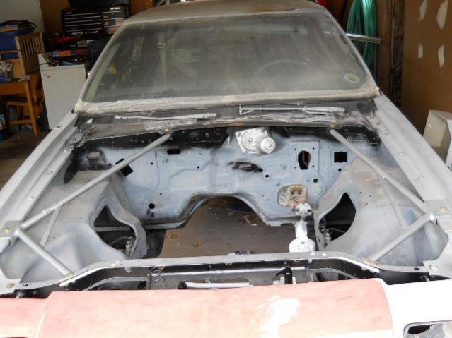

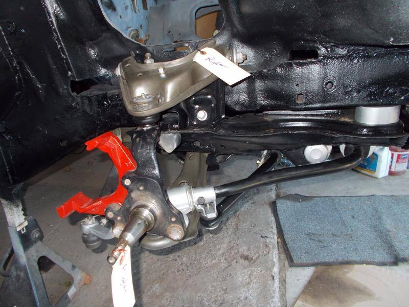

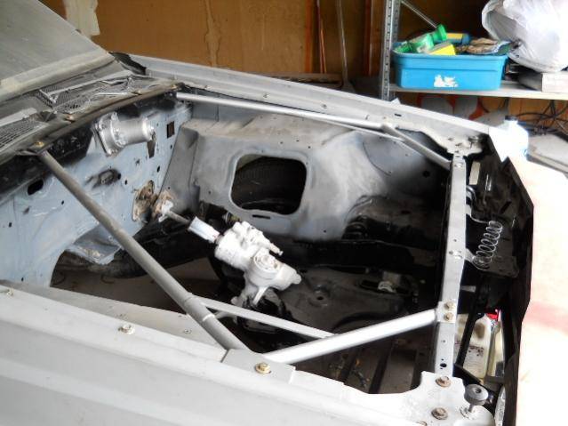

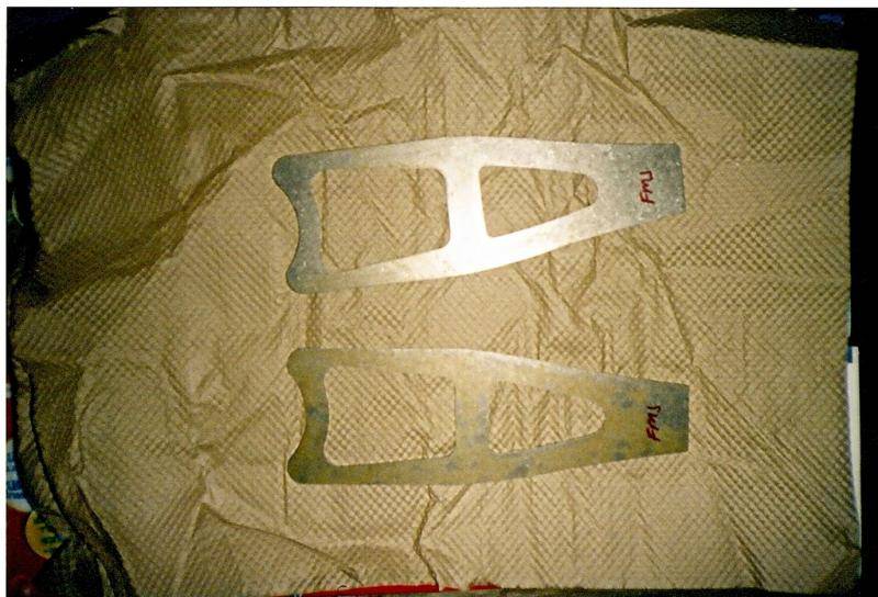

A look at the completed under-hood braces.

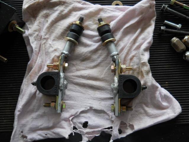

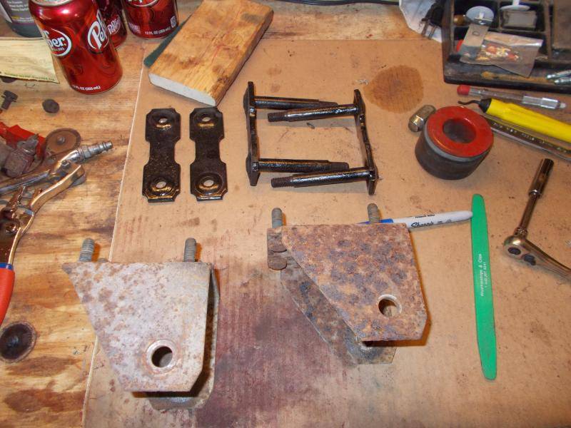

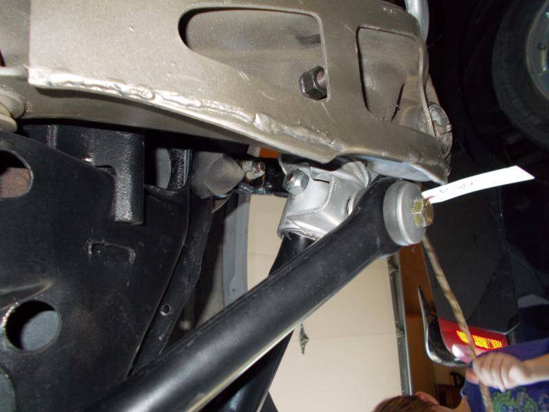

First attempt at rear mounts for the 1" rear bar. I drilled the sides wrong and had to redrill the mounting holes, the top is notched to fit next to a reinforcement. The brackets I made for the shock plates ended up being tossed in the scrap pile for a set of Firm Feel ones.

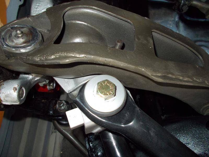

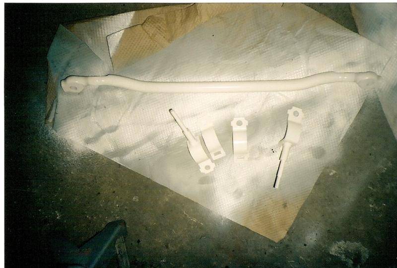

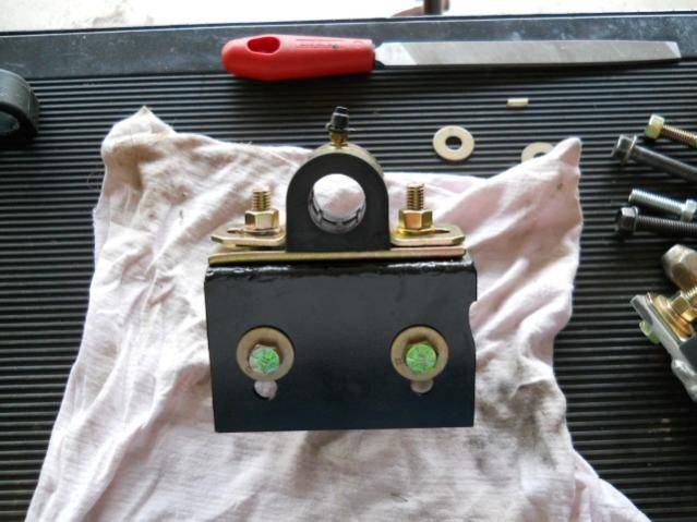

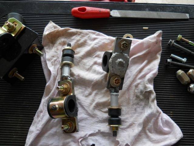

The Addco bar is a pain in the butt. I had to clearance the ends of the bar and the control arms. I also had to do some creative grinding to get the end bushings to seat against it.

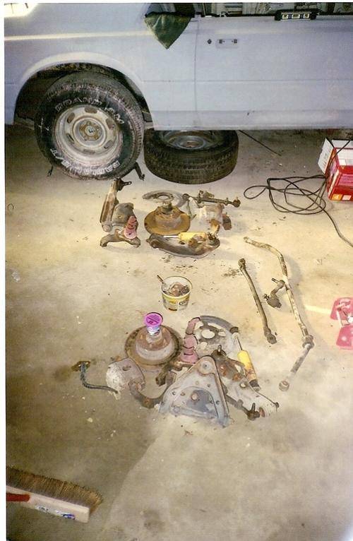

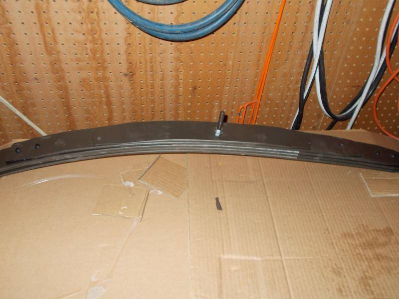

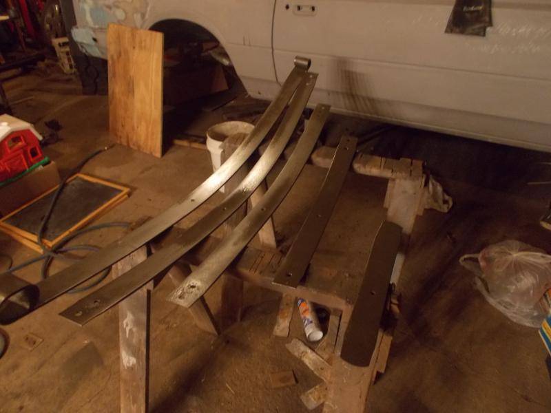

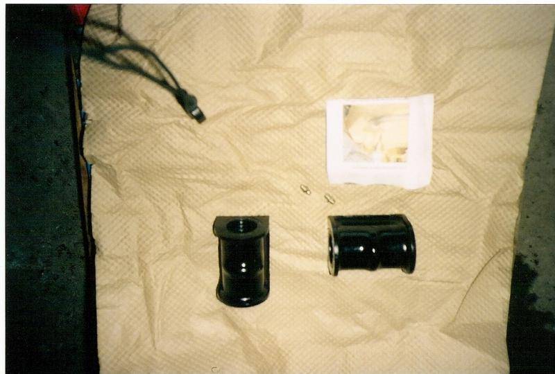

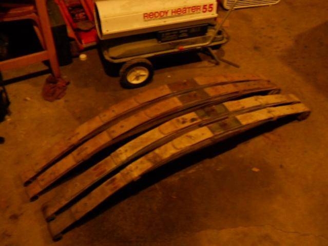

The front set of springs are a set of low mileage 5 leaf cop car springs that a local yard had on the shelf, they were still crusty. My 4 leaf springs were shot at best.

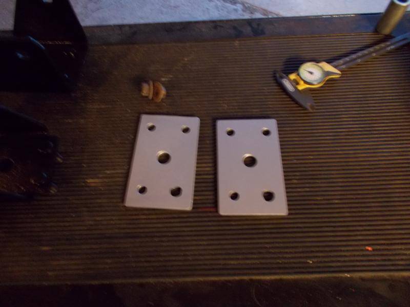

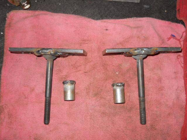

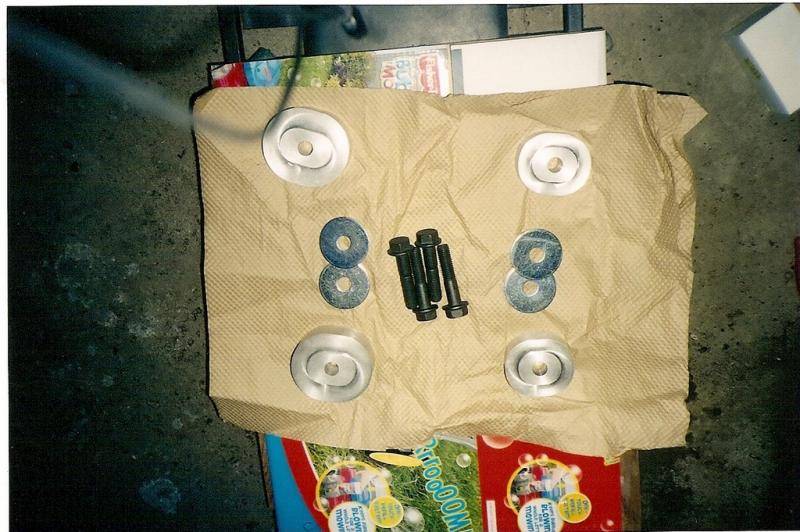

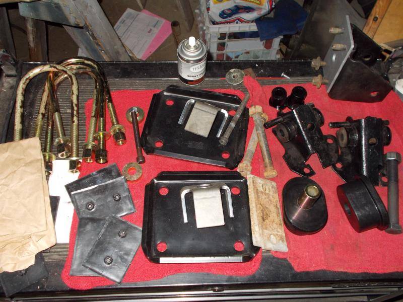

I made a set of support plates for the front spring hangers, dont mind the odd holes. I then bought the Firm Feel Iso-elimination kit, with sway-bar tabs.

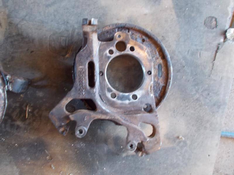

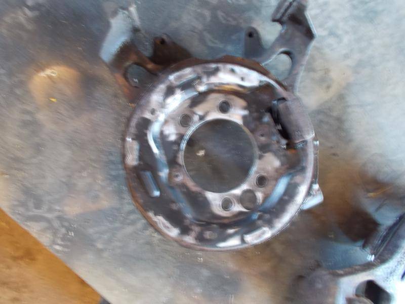

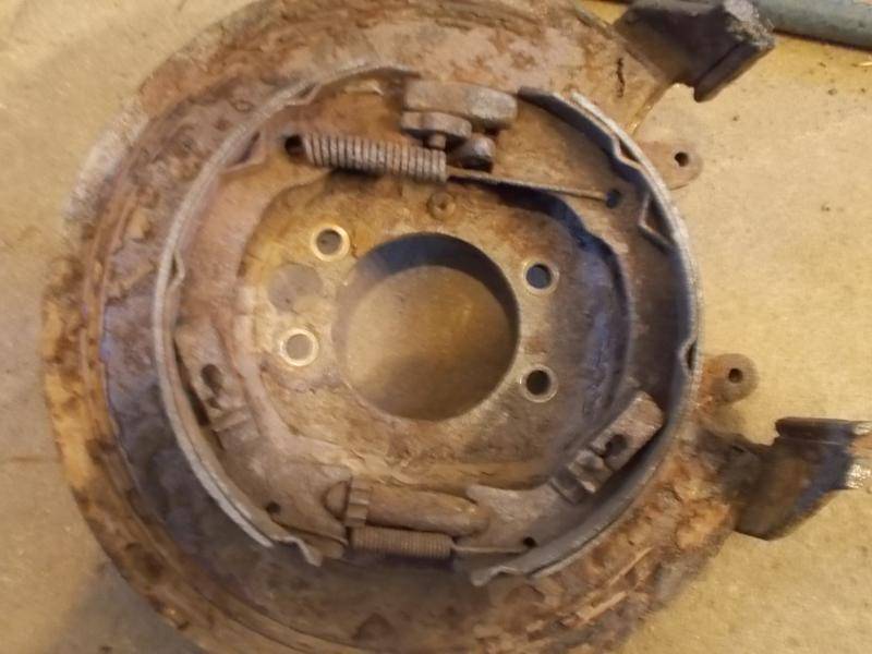

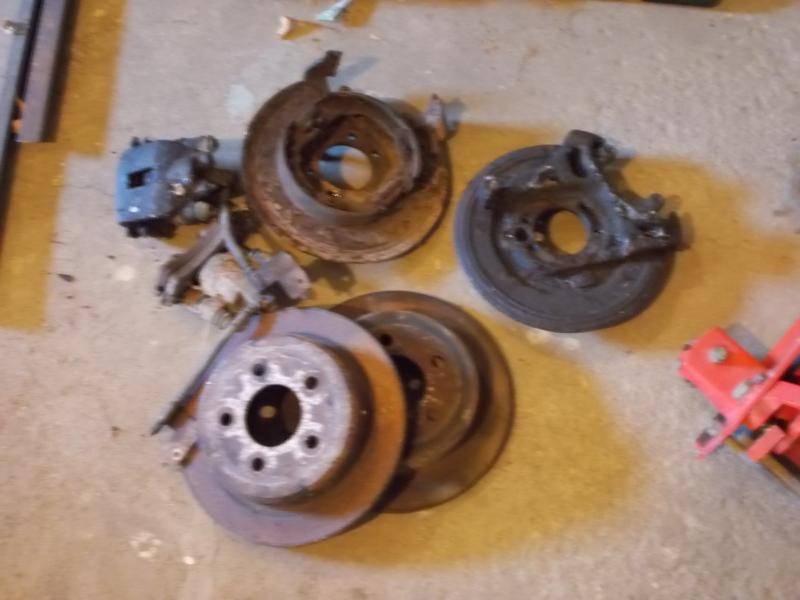

I cut away the dust shields, but left the park brake portion. The center bore needs to be slightly enlarged, I used a grinding stone on a die grinder, and the bolt holes needed a little bit of clean up. this is such an easy swap I recommend it for everyone. The jeep I got this set from was pretty clapped out.

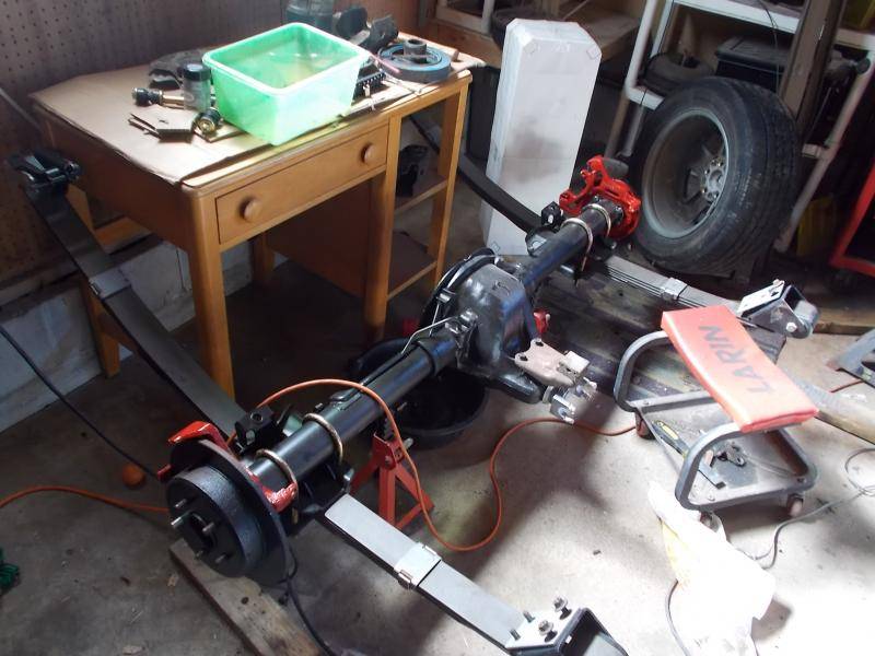

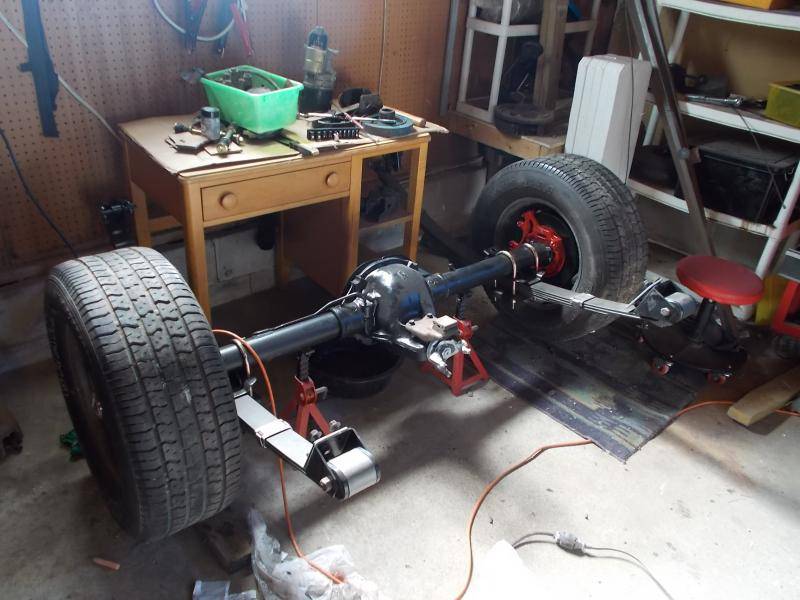

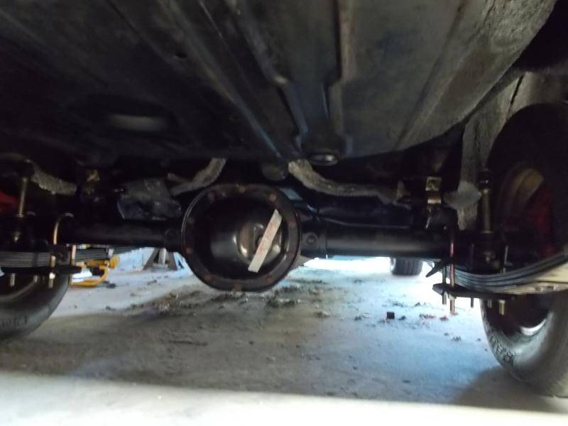

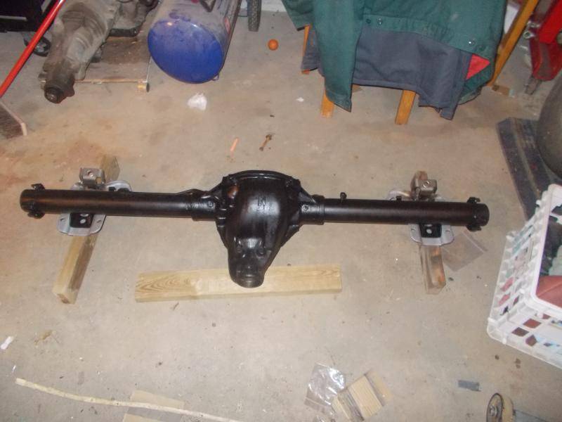

Semi-complete rear, used 3.91 gears with a limited slip, most of the Jeep brake swap, and a 7290 yoke off a 4x4 Dakota, bolted to '85 Diplomat 5 leaf cop springs, with Firm Feel Iso-delete kit and poly bushings.

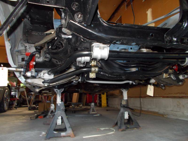

Rear is mounted with the Addco 1" rear sway-bar, just a few days before going to storage. The first time the Mirada has been on 4 tires since we had moved in almost nine years earlier.
