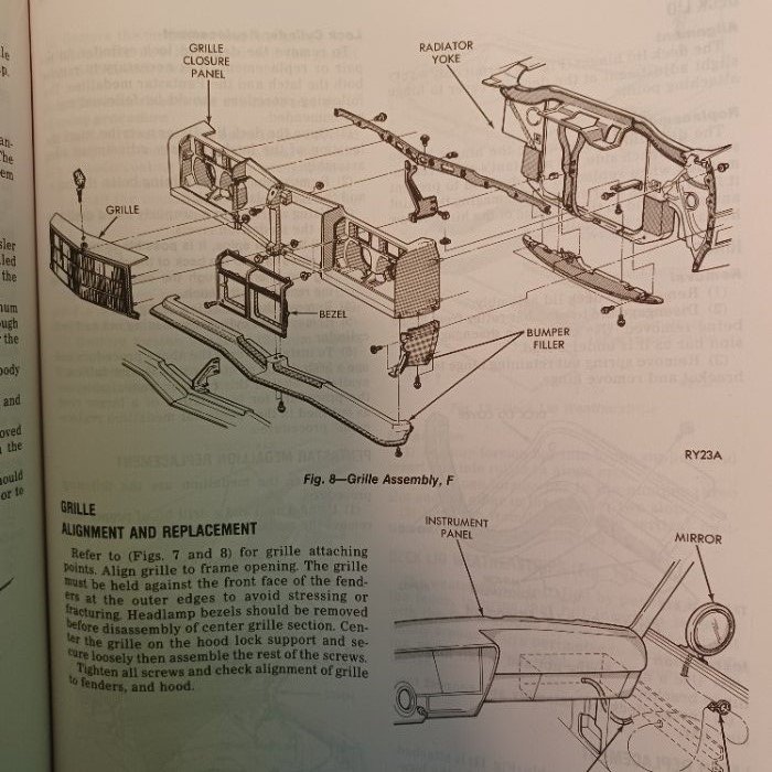

Nov 10, 2025 #3 C CM360 Well-Known Member Joined Sep 18, 2011 Messages 370 Reaction score 25 What's a fiberglass header? Is that the composite filler that attaches to the front of each fender where the headlights are housed?
Nov 10, 2025 #4 M Mikes5thAve Well-Known Member Joined Mar 3, 2020 Messages 1,954 Reaction score 828 Location Canada No it's the nose part that attaches to the fenders the grille and lights are in.
Nov 11, 2025 #5 AMC Diplomat Well-Known Member Joined Feb 14, 2023 Messages 1,979 Reaction score 956 Location NY CM360 said: What's a fiberglass header? Is that the composite filler that attaches to the front of each fender where the headlights are housed? Click to expand... "Grille closure panel" I've always called them header panels

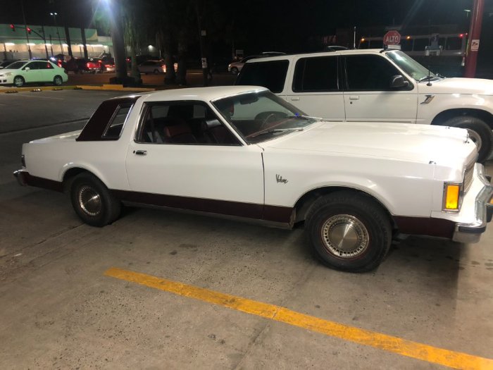

Nov 11, 2025 #7 SonOfaTomP Well-Known Member Joined Jul 22, 2017 Messages 698 Reaction score 256 Location Baltimore in Mexico they used to come from the factory like that. perhaps you could talk to user "MexicoSpec"
Nov 12, 2025 #8 Oldiron440 Well-Known Member Joined Apr 25, 2017 Messages 3,233 Reaction score 834 Location Iowa Basically it’s just a headlight mounts the grill attached to them also. The bumper filler is below the grill and headlights. I believe the fenders are the same between the two cars but the hood is different and there are fender extensions.
