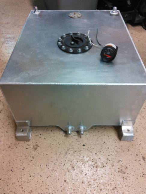

Thanks to Craig and his list, I no longer have to move my fuel tank over to clear the exhaust. I just have to cut those risers off so I can mount it flat with the sump through the trunk floor. AutoMeter gauge included.
So much for going on vacation, to the grocery store, or golfing. :icon_biggrin: I've always liked the idea of a fuel cell but I've never been willing to give up the trunk space.
LOL... the way I first read that, I was thinking you meant I couldn't do those things due to not having any money left :) Fortunately, I don't golf, because I wasn't even thinking about trunk space. But if I do take it up, with no back seat, there should be plenty of room to shove some clubs back there. Because let's face it, I'll be lucky if I can ever find ONE other person who will want to ride with me in this thing, much less two or three!
