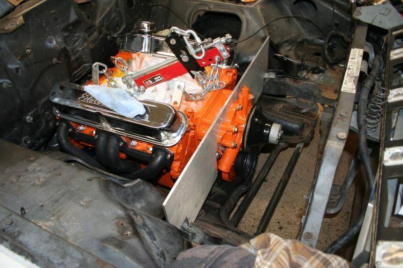

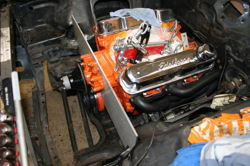

I didn't get all that far this weekend, at least not visually, but the plate is in place and more or less ready for me to make the actual brackets and weld them onto the rails. Except I won't be doing that, because despite more practice, my skills are not up to that task. There's a Mr. Weld here in town, so if he makes housecalls, that's probably my best bet at getting someone who knows what they're doing to do it. I have 3/16" steel, 3" wide to make the brackets from.
Every time I had to do something to the plate, I had to re-align and level the engine where I wanted it, so I made up some stands from angle iron that I put on the frame rails to hold the plate level. Saves a lot of time. They can stay there once the rackets are in to provide additional support, they're not hurting anything. I'll just weld them in place.
I'm going to have to pull the plate out at least one more time to weld in the brackets in front of and behind the plate, and to cut a little more away from the plate where the lower radiator hose attaches to the pump. They didn't cut as much away as they would have needed to for a stock water pump. And to install studs in place of those bolts of course.

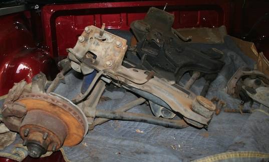

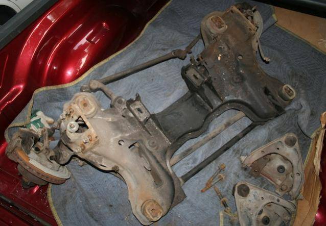

OK, since I'm pretty sure I will want to go with stock motor mounts at some point, probably sooner than later, tonight I picked up an entire front suspension assembly. I might rebuild it over the winter and have it ready to go in the spring... if I get ambitious enough lol. This will be the easy way to go though. The only reason I didn't do it this way to begin with is because I didn't have one. Live and learn...

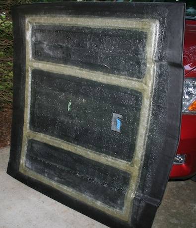

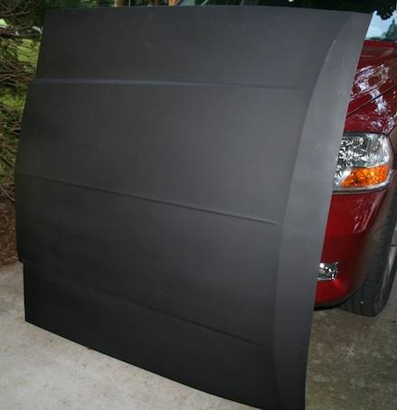

Then, a friend was driving down to VFN in Chicago, so I bought the Mirada a little gift. Should take 50+ pounds off the front, easily... :icon_super:

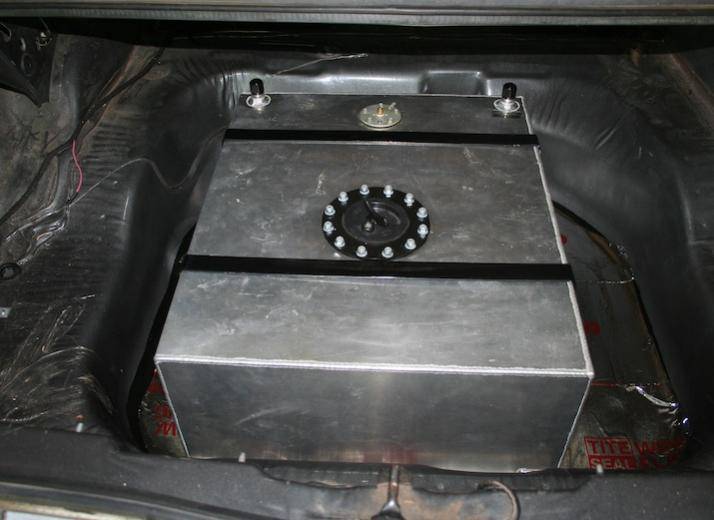

I'm finishing up my fuel cell installation and I need to decide whether to make the holes (4 small ones) in the mint condition original trunk carpet/mat, or just use some generic carpet (or nothing). My first instinct was to spare the trunk carpet since it's perfect... I always hate to destroy nice original parts... but the trunk carpet would look SO NICE under the aluminum cell! Plus, it would be nice to not have to store this trunk carpet elsewhere, it's not like it's small. Conflicted... what should I do!!! :icon_question:
The generic carpet I think would look like crap, fit wise. So I guess the options are really the original carpet, or nothing. How rare is a nice J-body trunk carpet?
I don't know how rare they are but my personal take is
If the cell is permanent and not just a temporary thing then I'd go with the nice carpet....it's part of the whole package.
And myself.....I'm getting tired of keeping things for "some day"
The cell is permanent. The car is not going back to stock. That wasn't meant to be with this one. And the more the years tick by, the more I have the same feeling about "some day". Too often, those "some days" never come. Thanks for the thoughts.

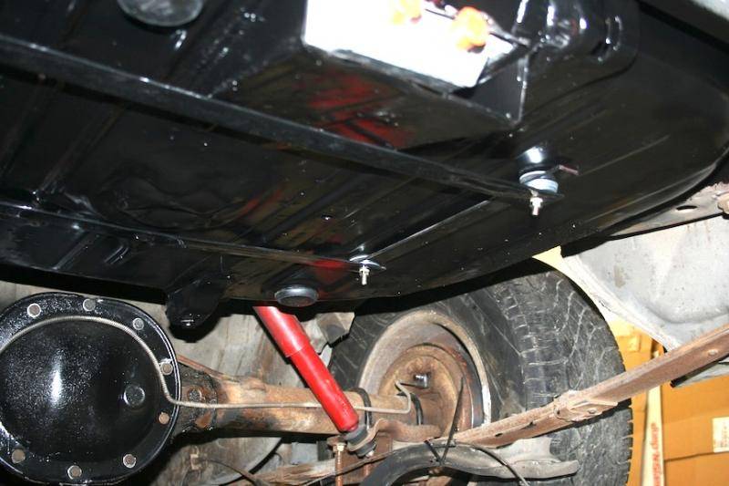

Fuel cell is in. Took awhile because I had to clean up then POR-15 and paint the bottom of the spare tire well, and the same under the entire back third of the car before I installed it. There was hardly any rust at all, but what little there was, I completely removed and treated prior to the paint. I do love working on a solid car. Pay no mind to the crusty 8.25 rear, I filled it with gear oil & sure grip additive, painted the cover, but that's it, since it's not permanent anyway. I opted to not install the trunk carpet until after I paint the jams since it'll get dirty during that anyway.
Too bad you can't see my handiwork with the welder in creating the sump cover... or maybe that's a good thing! It's solid though.
