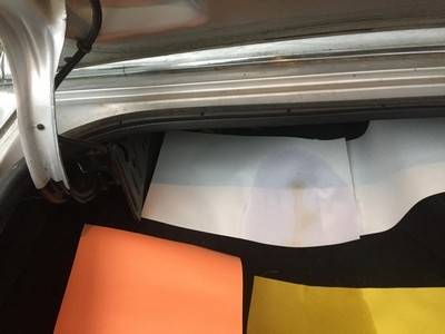

Full trunk view -- I spy a leak -- just to the left of the spare tire.
Water came down (see the rust stain), hit the white paper there on that ledge and then dripped down to the bottom getting the yellow paper wet.

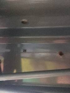

Here is what is above it:
So the water is leaking from above, getting under the vinyl roof/belt molding.
For the time being, I'm adding more silicone above to be sure I get the leak stopped. Next year when I repaint, I'll have to address the bonnet/belt molding issue so I don't drive around with it held together with silicone.

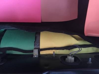

This last night and this morning we had very heavy thunder storms move through. Lasted about 4 hours.
I checked the trunk and the leak I had identified is now stopped!
However there are two issues:
1. there was water in the well of the trunk ... carpet was saturated but I couldn't get a read on where it came from
BECAUSE

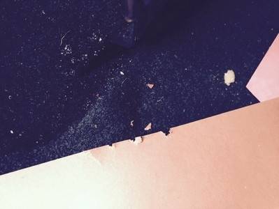

2. a mouse/rat had gotten in there and chewed up the construction paper and made a nest.
So, dried out and cleaned up the trunk and will put out glue traps before the evening.

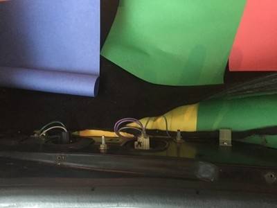

I have the trunk dried out again.
New construction paper laid out.
Added a glue trap to the middle, with peanut butter scent.
We'll see what happens tonight.

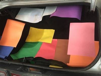

Good News!
5 hours of storming, raining, wind -- no water in the trunk!

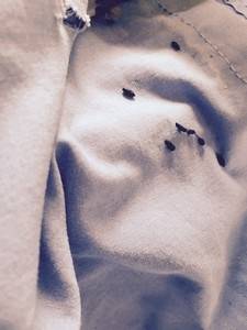

That mouse has figured out how to move from the trunk to the cabin of the car and knows how to avoid glue traps.
trunk:
Rag on backseat :
Which means I'll have to empty everything out of the car and lay out more traps.
I've already put mothballs in a bottle with holes in the engine compartment and that seems to be working.
