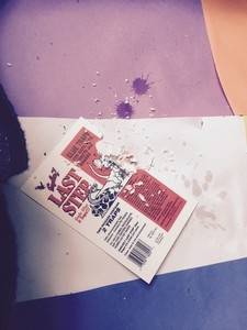

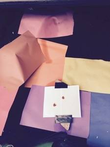

What I found yesterday:
What I found today after I replaced the trap:

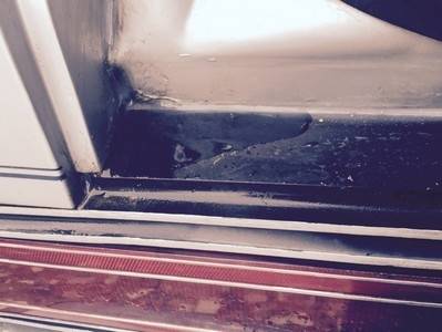

Notice there is water - again- on the upper ledge at the rear and there is water under the granite with the traps taped to it.
Rain came from the east instead of the west and south.

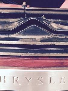

Water appears it came in directly behind the 'chrysler' plate in the center at the back:
The trunk latch is to the right of my hand and the shiny area under the electric lines is water.
Left side outside doesn't seem to be leaking
There is a gap above (the top angle). Is that supposed to have weatherstripping in it? When the wind came from the east it was headed directly into the back end of the car.

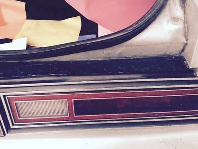

Here's the right side:
Pictures were funky since I was trying to get images before the rain started again. Doesn't seem to be leaking on the right side.

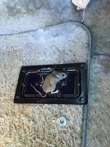

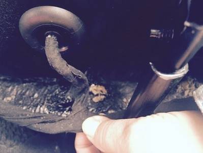

Yesterday...
Old peanut butter.. mouse poop ... mouse hair
Decided to upgrade from a mouse glue trap to a RAT glue trap:
Today:
He had chewed almost two inches of plastic on the ride bust behind his head trying to get free. Was still alive when I found him. He is not alive now.
Tomorrow, I get to clean up everything interior again. There is mouse poop everywhere.
How did he get back and forth??
My fault entirely.
I had created the avenue by removing the pedestal, third brake light when the lamp socket in it busted. Never, put it back in since I needed to fix it first.
Doh!
