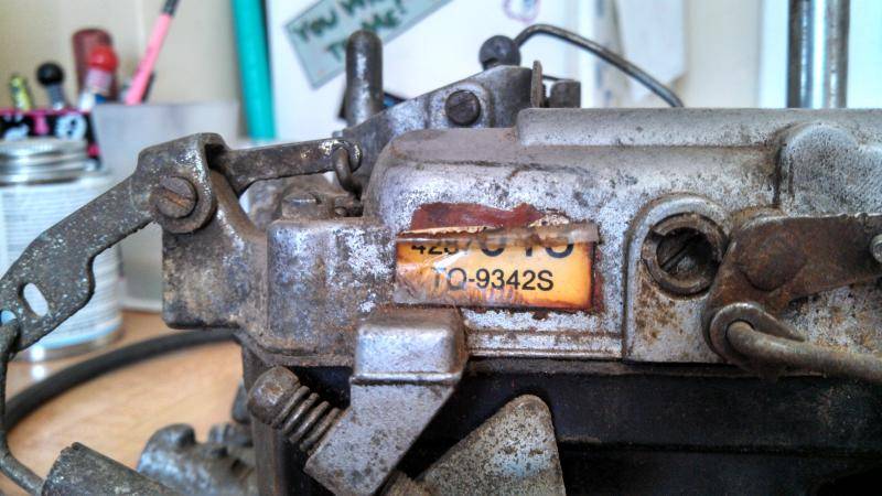

According to the Vaanth list, this is a carb from a 1982 318 pickup truck (9342S), with Bowl Vent (solenoid controlled). Might want to look at having it rebuilt by a TQ expert (look up some of the threads on the TQ, there is a guy who is supposed to be really good with rebuilding them), and having him put in the vacuum port. Then get a distributor with vacuum advance, and disconnect all of the ESA/Lean Burn stuff, and roll up all of the wiring associated with that system. This way, you stay with the same throttle linkage and the cruise control should continue to work (assuming it works now).
Most of the time, the carb type is scribed into the base plate of the TQ, on a vertical pad near the mounting bolt flange, not on a lable. Maybe its a replacement of some sort, or a rebuilt one that a label was added on to.

The 9342S already has a ported vacuum fitting for the vacuum advance. As I'd noted, most truck carbs do. There is no trick to rebuilding that carb; it's got just the bowl-vent solenoid which I explained in my post simply needs to be wired to 12V+ key-on. It is not an ELB/ESA carb nor is it an "emissions" or feedback unit. It's from a truck.

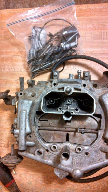

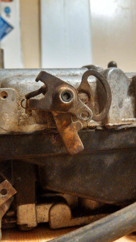

already had a casualty..
the tiny little bolt that goes on the end of this sheared off
I got all of the screws out, but it still won't come apart, gaskets sticking? Don't want to pry and crack something..
I may just take you up on that offer, I'd say I'm fairly knowledgeable, but not terribly experienced. Might be something best left to an expert. I see things like "Slowly open the primary throttle valves the specified distance from the throttle bore walls." Then no specification listed? hmm, very helpful.. Glad I got my degree in this, and all of my State certs.. Which rebuild kit do you recommend/prefer?

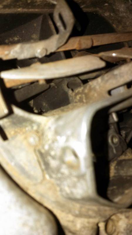

Hint: look behind the secondary air valve (the big-ass "choke flap").
I hate to tell you this, but there really was no reason to attempt to remove the screw you broke. You really don't need to tear apart any of the linkage except for removing the link rods to disassemble the three main sections.

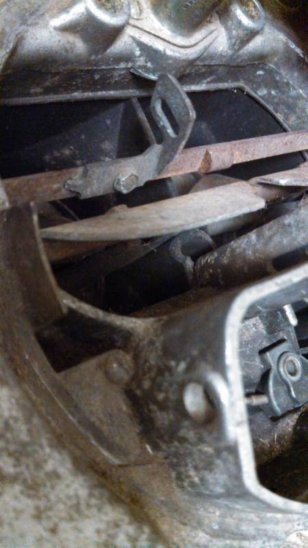

Fortunately it doesn't seem to have had any effect, it broke short enough that the piece is still firmly attached.
Not sure what I'm supposed to be seeing behind the secondary,
BUT, it does look like a little piece is cracked off in there, may or may not matter..

Doh... there I getting mixed up again. I was thinking of the main-body screws behind the primary choke plate toward the secondary side, which you've gotten out already. It looks like you've got all 10 screws out so it should split open. Hold down the throttle body at the rear mounting tabs with your fingers and push up on the air horn with your thumbs. It might take some effort, but it should split.
That chipped-off piece inside is just the boss for the air-cleaner stud. It doesn't look like it should cause a problem since the threads go pretty deep.

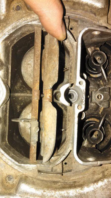

Don't remove the secondary air door or the throttle butterflies or shafts. That's just going way further than necessary and opening a can of worms for potential failure. Realistically, you shouldn't have even taken out the choke plate. When you reinstall it, use red threadlocker on the butterfly screws so they don't vibrate out and fall into your engine.
Roger that. I have a couple things of blue laying around, I'll pick up some red before I get to that point. I just took that off to get the linkage out of the way to get to the one screw a little easier.

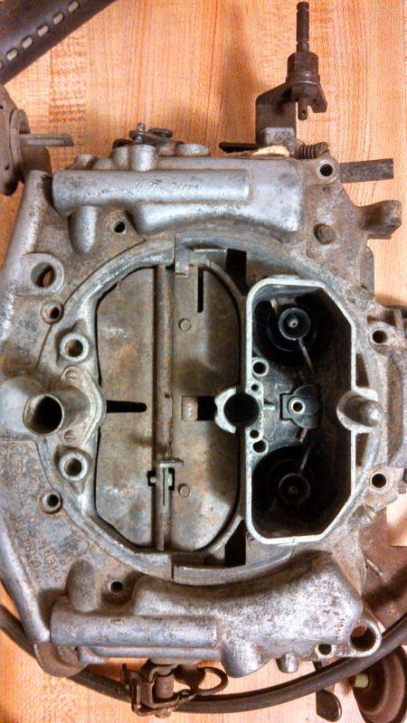

yeah, no.. I tried holding the bottom mounting tabs with my left hand, and grabbing the fuel inlet rails with my right, and pushing/pulling as hard as I could, didn't budge. I bolted it back on the intake and used a small pry bar, and managed to get the bottom section to seperate. But, now there's no way to get the middle and the top apart without jamming a screw driver in between them and cracking the phenolic to bits. Might drown it in Mineral Spirits and hope for the best.....
