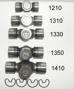

There is only one factory slip yoke I know of for the A904, and it uses the smaller 7260 U-Joint.
When Chrysler went with overdrive (A500/A518, etc.) they went to the A727 yoke or in HD cases, went to a much larger slip yoke. The slip yoke used on my '97 Diesel pickup could be melted down and recast into three different A727 yokes and you might have enough steel left over to make a A904 slip yoke. That pickup also uses 1410 series U-joints which are 4.188” wide (almost an inch wider than 7260 joint).
I don't have any recommendations as to what to do about U-joint size with an A904/A999 slip yoke. One possible solution is to go overdrive – but that might be overkill.
I've even seen Dodge 1-ton dullies built with 7260 joints.
Edit: add picture
The 7260 is roughly the same as 1310 and 7260 is also roughly the same as 1330.

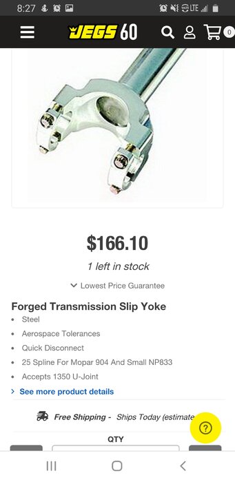

Jegs has a slip yoke for the 904 transmission that uses a 1350 u joint, I have one I'm using in my bracket car.
