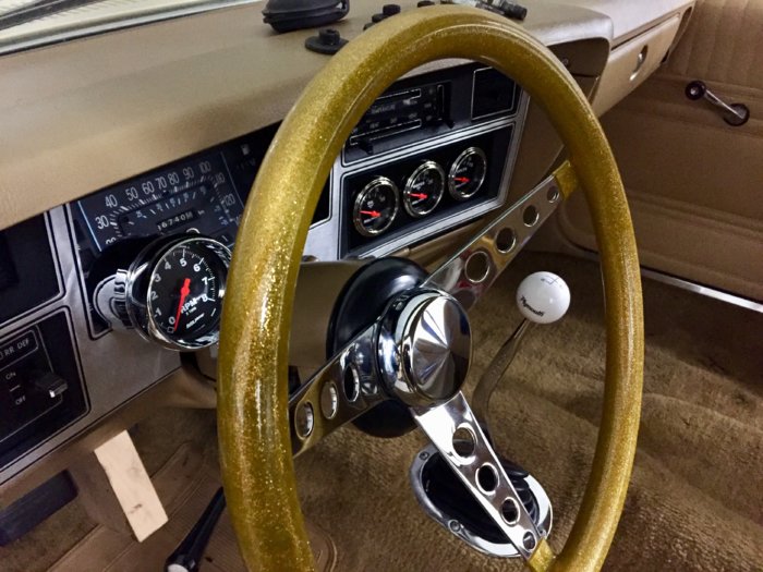

Just one large hose clamp around the column.

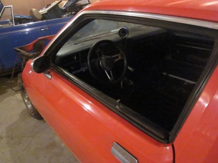

I got an adjustable shift light from jegs real cheap. I made a bracket that mounts it to the rear view mirror with a wing nut. it takes 30 seconds to mount/dismount. I just put it into the ash tray when not using it. its too hard to miss seeing it go on and you never have to take your eyes off the road/track.
I like the idea of the rear view mirror as an attachment point – but I do caution about the mirror buttons (the part that glues onto the windshield) can (and will) come unglued. When that happens, you are now in a situation of not having a rear view mirror - until you reattach it.

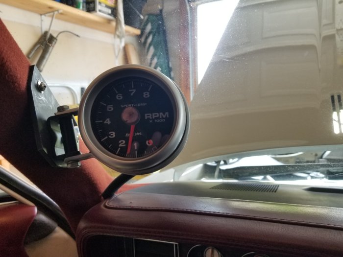

I've got mine mounted to the A pillar via a bracket I made out of aluminum flat stock. Used an existing screw, but did have to drill a second hole.

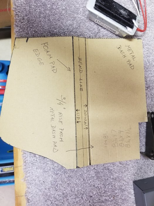

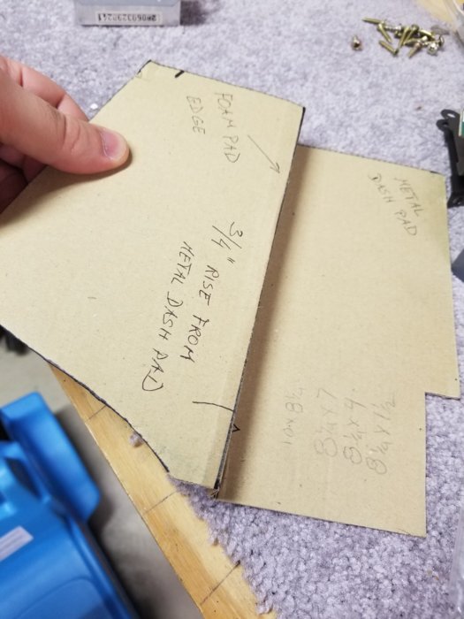

The best setup I've seen is @Diplomat360 setup. He made a bracket that screws into the metal dash right behind the dash pad. I've still got the template he made. Maybe he'll chime in with photos of the install.
