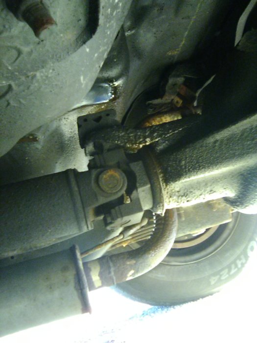

I don't think its full, a few days ago I noticed that there's a leak on the front of the diff, its pretty slow, but if I park somewhere for a few hours there is a small puddle, I plan on getting some fluid a little later
3,178
819
If its leaking at the pinion there's a chance that is the bearing that's bad, also I have seen the pinion come lose causing noise in the diff. and a leak.

Well if the pinion nut comes lose it will cause noises in the differential just like a bearing failure and can be corrected inexpensively.

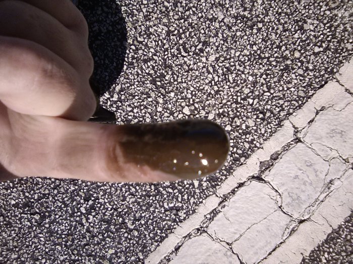

As you can see the fluid does not look very good, I climbed underneith this morning to add diff fluid (it was only slightly low) and then I saw this, back in 2017 when we had the hurricane the interior was soaked the engine filled with water, so did the differential, I had the fluid replaced and never though about again, I now think maybe I should've had it done a few times (I had to have the engine oil changed either 2 or 3 times before it looked normal again) so I'm assuming that's why it looks like this
