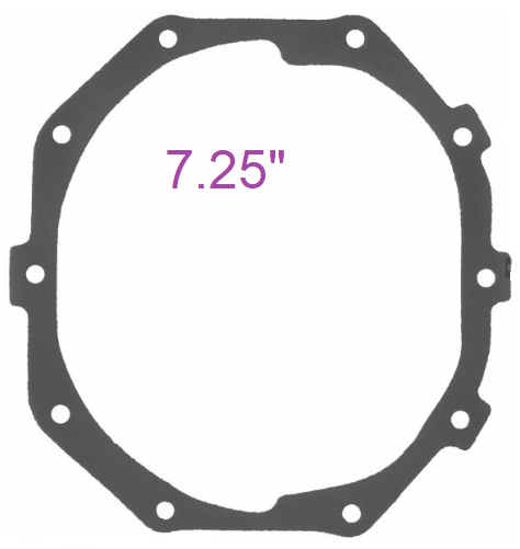

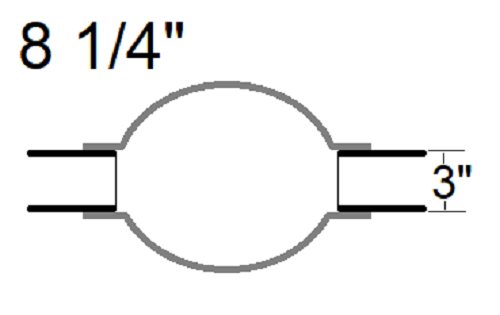

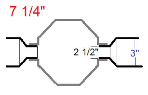

To determine if you have a 7¼” or 8¼” – look at the axle tubes where they go into the center housing and look at the inspection cover.
The differential tube size (the tubes that goes into the center housing) is 2½” diameter for 7¼” differentials – which is the size of all 7¼” differentials (from ’60 to early ‘90’s). Now with that said, somewhere in the late ‘70’s, Chrysler changed the tube diameter on 7¼” differentials to 3” – but they have a distinct taper down just before the center housing. That way the ISO-clamp system can use either 7¼” or 8¼” differentials. The early F & M bodies with 7¼” use a different ISO-clamp because of the tube diameter has different spacing – but I doubt there are many of those 7¼” differentials left out there to worry about.
The tube measurements are outside measurements – even though it is hard to tell by my crude picture(s).

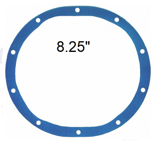

The 7¼” cover is shaped like a stop sign (octagon) and 8¼” is oval shaped.
All 8¼” covers have 10 bolts.
Some 7¼” covers have 9 bolts and some have 10 bolts (not sure when that change was made).
I have a few pictures of a 7¼” – but couldn’t find them, so I drew a rough sketch to demonstrate what to look for. The 7¼” is the ONLY differential Chrysler made with a step-down tube.
