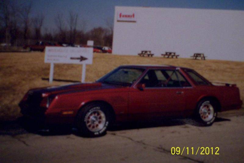

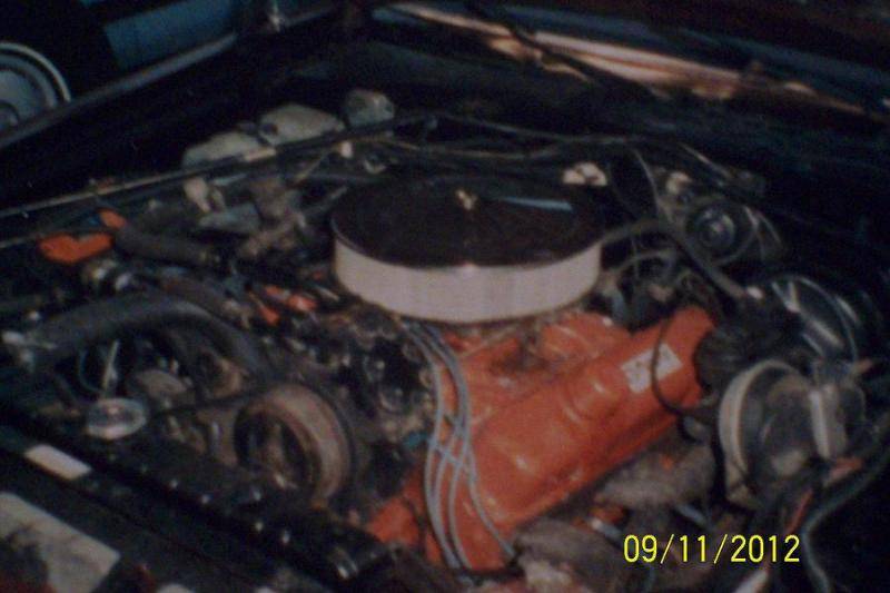

Just saw this thread, so I thought I would throw in my 2 cents. I put a 440 in a mirada in 1990. I used stock tranny mount and location, but I actually cut the drivers side motor mount in 1/2 , moved the spool end forward, welded back together with gussets. I also notched the k-member. I also used heddman headers 1 7/8 3.5 collectors, but I don't remember the p/n. I kept the p.s. a/c and p.b. , but had to remove the little drip thingy for the a/c on the firewall. For the brakes, I used a k car booster, I think I had to put a bushing in where the pin goes through because it was a different size. Radiator came from a c-body, three row that barely squeezed in. I had the lower rad. hose nipple replaced with a 45 degree elbow to clear the torsion bars because the rad was taller than stock. Speaking of the torsion bars..... One snapped about 6 months after the swap.... fortunetly it broke in the night while we were sleeping! I figure the extra wieght did it...all cast iron, no aftermarket aluminum. Many good times in that car, total sleeper . My wife sometimes drove it to work and said her favorite thing about the car was that she never had trouble merging with highway traffic !! I " almost went the same route on Modoba, but decided against it......I have teenage boys you see...lol
Actually had big plans for that car. I built the engine with stock compression because I was going to turbocharge it. I built my own manifold for the turbo, had a rotomaster turbo made for the application. I bought a b&m superjection efi with a mass air flow set up and bigger injectors for the 440. Expert power estimates were 550-600 hp/ 6-700 ft lbs , all less than 5000 rpm and 7 lbs of boost. But..... Babies and life came along and the car plans faded. You know how it is. So everything gradually got sold to pay for this or that. But I am a very blessed man with my family, and wouldn't trade it for any car or anything!:love7:
440 mirada pics
Found a few low quality old pics of my 440 mirada circa 1990.
Just remembered a few other things. I installed solid k-frame bushings and removed the rubber donut on the steering shaft to clear the header. I think I also ground a couple teeth on the steering shaft to mount the wheel straight because bolting the the column directly without the rubber biscuit caused the wheel to be out ( not straight) There may be headers available now that don't need so much fiddling.
