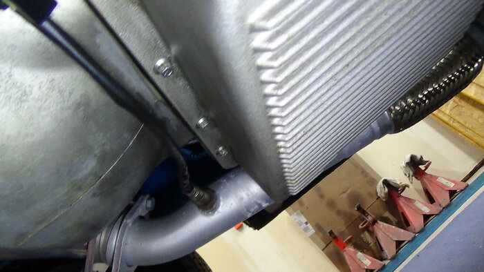

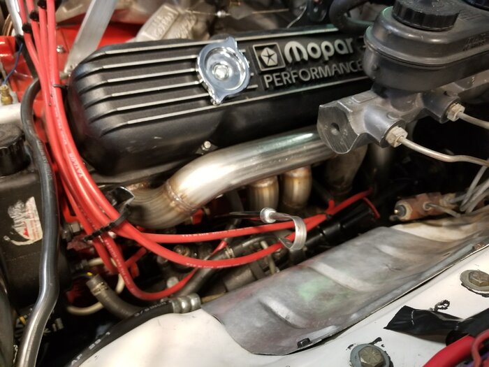

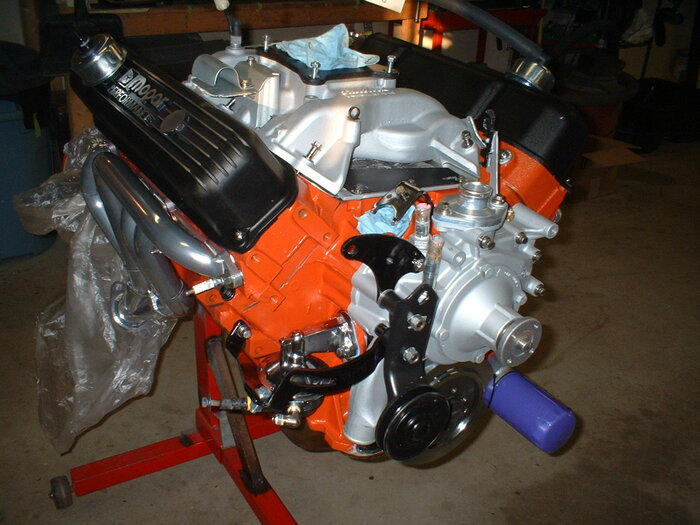

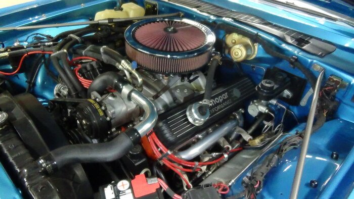

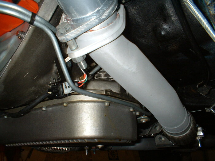

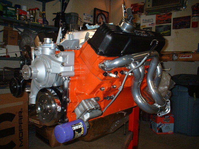

Those headers were hard on the wallet, like $820 to the door but worth every dollar.
The outlets are in a great spot. I upgraded to the ball/socket connection vs flat flange and gasket so, no leaks. I imagine most any shorty header would exit about the same spot, don't quote me though. Not the best photo's but it'll give you rough idea of location. Pay no attention to the oil leak:oops: These are from 6 1/2 years ago, before fixing the leak.

Always glad to help, or at least make an attempt to :) . I know I've got some better photos of the fitment, if I can find them. To call my picture files a mess, is a gross understatement.
I liked the headers because they're built well, don't get in the way of the spark plugs (everything else does, but not the headers, lol) and the flanges are thick. That along with the graphite Schumacher gaskets and stud/nut kit mean zero leaks. I've even had them off and reused the same gaskets once. About 25% of the cost was the ceramic coating and, of course, shipping.
Only real problem is the tubes are really close to the starter, like 3/16". At first I had a new Mopar mini-starter, and it worked fine until it got a 10 minute hot soak. Barely turn the engine over, sounded like an old Camaro trying to start, you know the sound. Switched to a Power Master XS Torque mini starter and problem solved.

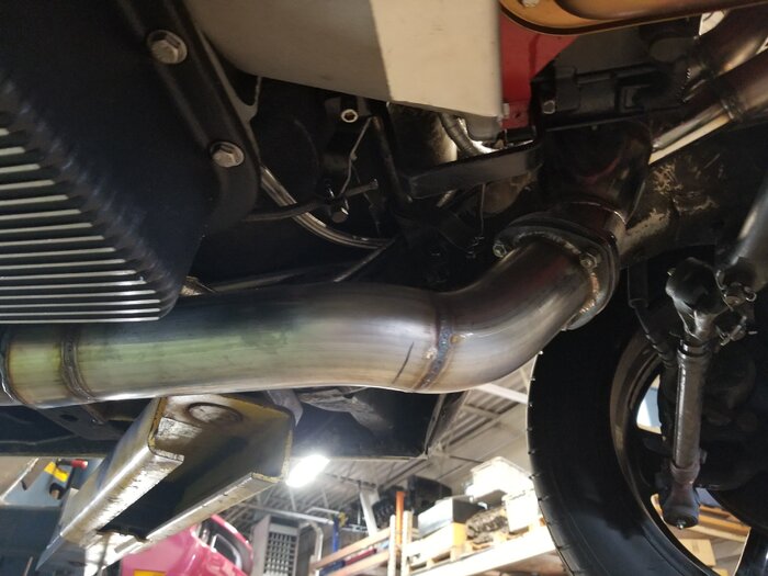

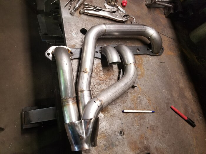

Headers by Ed. Buy the flanges and any bends you want and stitch them up exactly the way you want them. I have done a bunch this way and I braze them to make them quieter. Tack them with a mig, then once they are dialed in pull them out and braze them. Make them yourself, that way you know they fit correctly

I paid a local custom exhaust shop to make a set of shorties for me. Had enough of long tubes with the small block before. Complete pain in the ass. Shorties are 1 7/8" primary with 3" collectors. Made from stainless.

Great point. I forgot to say that, but aside from me hating headers, if I have to have them for some reason I make them from stainless. It's not something I want to do again in 6 years. If at all possible, I find the best exhaust manifolds I can get.

That's the ONLY reason I made headers. The fit on both sides. When you do swaps involving things that weren't meant to be, headers become part of life, but I am not a fan. Go with stainless, make the most of it. Also, even though numerous people do this swap, they don't always fit exactly the same. I have done the swap half a dozen times, and even if I use the same mounts, the clearances can vary by up to an inch and a half in a couple of places. The engine tilts in a couple of different ways. When they made a master pattern to sell headers, they fit the very car they had available at the time. They may not fit yours. I would rather buy quality materials and make headers to fit the specific vehicle I have on hand.
