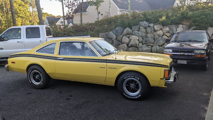

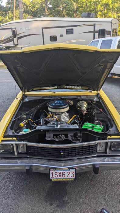

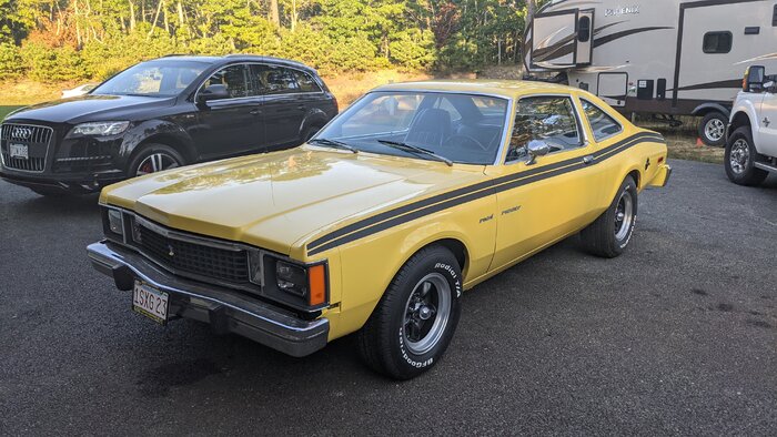

Haven't posted about the car in awhile. I've got everything working to get the State Inspection Sticker. I changed out the front tires which were 195/70R14 to a 235/70R15. I prefer that look, makes the car look a little stouter, plus they are able to handle the weight of the big block. I have decided to upgrade from the carburetor to a fuel injection system. I guess I need more punishment, lol

Nice! How does it drive? If it's like my BB Aspen, it likes going straight more than going around curves. :cool:
Lucky Charms
May 1, 2021
27
34
02675
For a car with a lot of weight up front, it doesn't corner bad at all. The steering is very responsive, and with the 11" drum brakes in the rear, it stops very well.

I've always been considering aluminum heads and, it may just happen. Originally I was going to during the build of the car but the old budget thing had other ideas at the time. The ones on there now are '63 413 closed chamber heads with 440 valve sizes, throats opened up, guides tapered, port matched, etc, etc, etc. Not sure what they weigh other than it's a heck of a lot.
