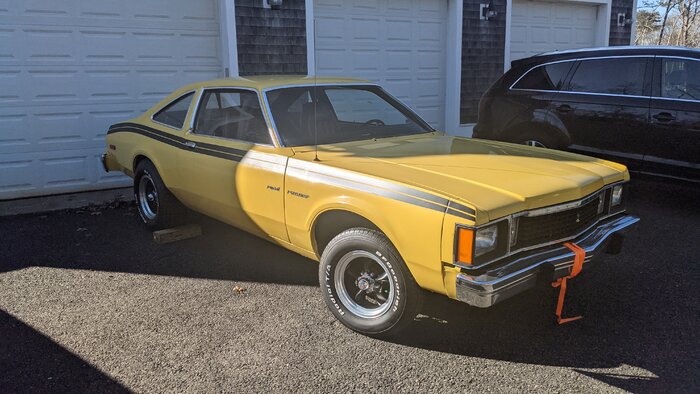

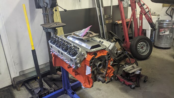

I bought a 1980 Plymouth Volare Roadrunner clone car from DCAspen. Super guy to deal with. The car, which was originally a Slant 6, comes with no mother or transmission and a 7-1/4" rear axle. The plan is to install a 383 B-Block with Mopar Stage IV cylinder heads which have raised intake/exhaust ports to use a 440 intake. It will be also receiving a 727 transmission and an 7-3/4" rear axle.

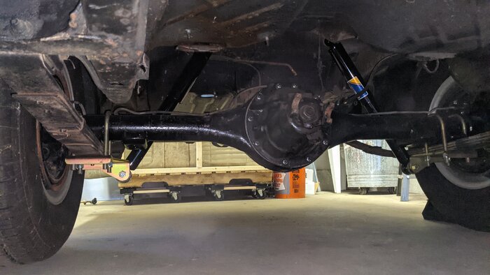

02675

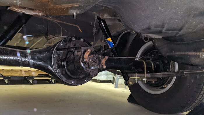

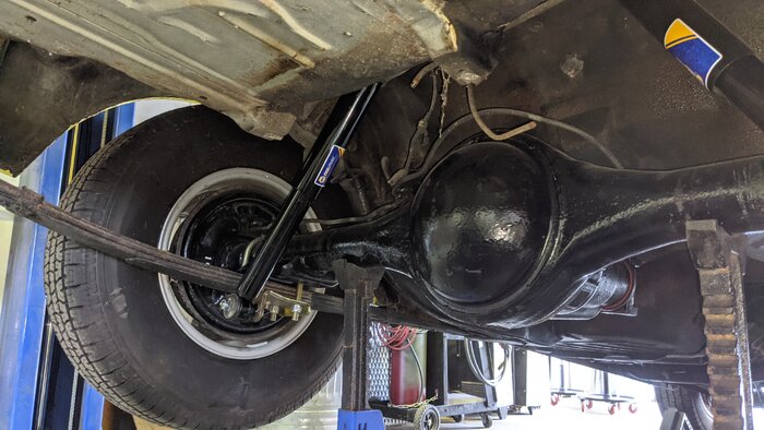

8-3/4" rear axle installed. The axle was out of a 1970 B-Body. Some one had moved the spring pads inboard, so I just ordered a new set of spring pads and set them up for the correct spring width. I picked up a 3.23 sure grip third member. The axle came with an 11" drum brake set up. I bought new spring plates and a set of shocks for a 1970 Dodge Charger. I also install the Mopar updated green bearings to eliminate the axle shaft end play adjuster.
2,991
Nice! Good suggestion is to replace the yoke with a u-bolt style, especially since your engine is going to be "enhanced":D . Much stronger than the straps and grade 10 (or whatever they actually are) valve cover bolts.

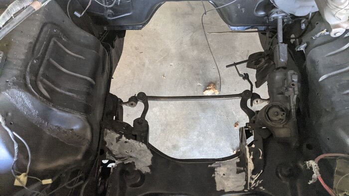

Removed the Slant 6 mounts from the K member. Ready to mock up the engine and transmission so I can locate and weld in the mounts.
3,171
818
I fabricate solid mounts and brackets for my Plymouth. I cleared the K frame set the 440 and 727 in place using the stock trans mount then fabricated front mounts.

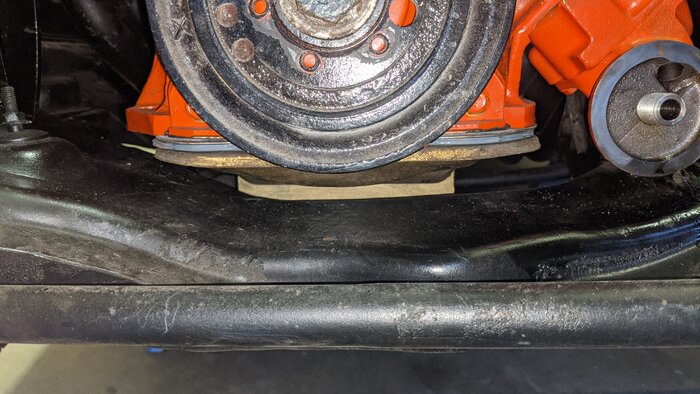

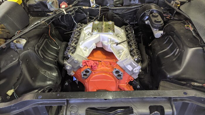

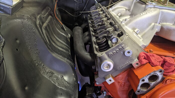

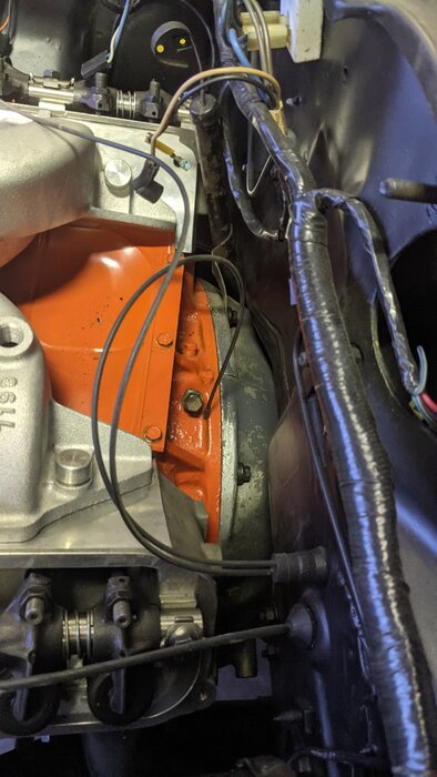

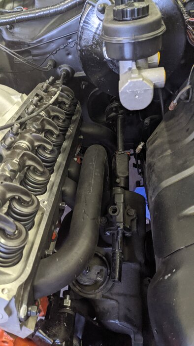

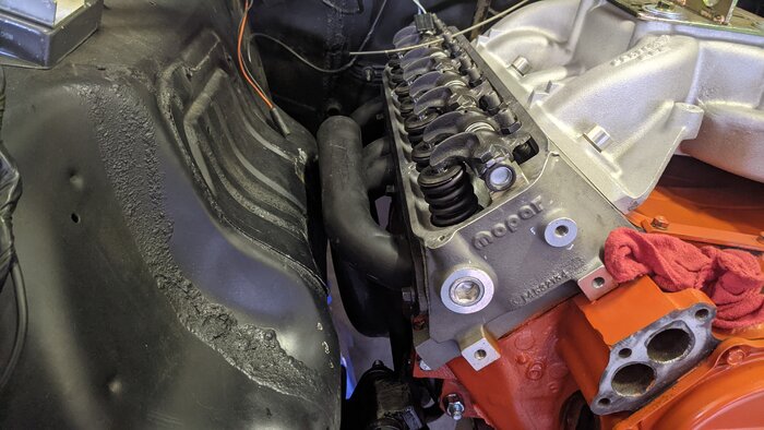

I have the 383 bolted in and the mounts installed. I loosened the transmission mount bolts and slid the transmission as far forward as possible to give me the most firewall and steering linkage clearance. I had to modify the universal mounting kit from Tin Man by cutting up the mount kit and shortening the ears on the mounts. I kept the engine as low as possible to give me space around the power booster. I have to use the taller valve covers due to the aftermarket 1.5 ratio rockers .View attachment 43562 View attachment 43563 View attachment 43564 Clearances are tight, but it fits nice.

I have a 400 in my 77. Which headers did you use? I used ones for a E body.

It also looks like it is already converted to a K car booster.

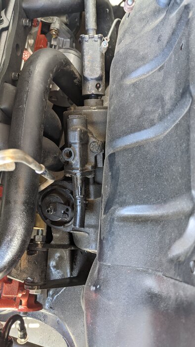

No Mother? Father?
3,171
818
Those look like mopar rockers...

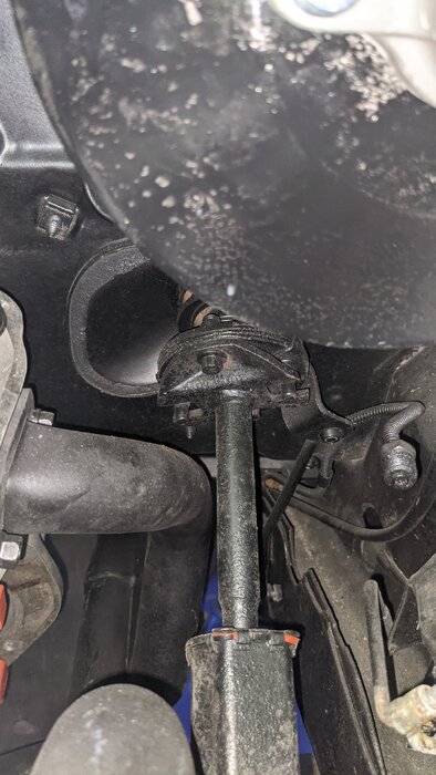

I've got a 440 in my Volare with 2" headers so my problem with the same tube was more severe, I needed to moved the steering column over and got rid of the rag joint.
