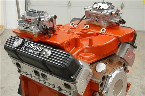

Hmmm….. I dunno…. Here’s a Mopar (don’t know what) with a crossram setup;

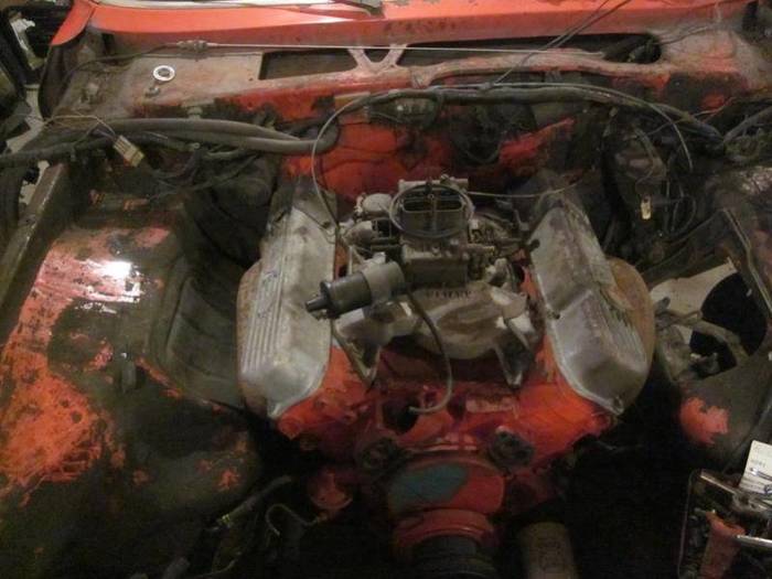

Here’s MY F-body Volare with a 413 big block:
I dunno….

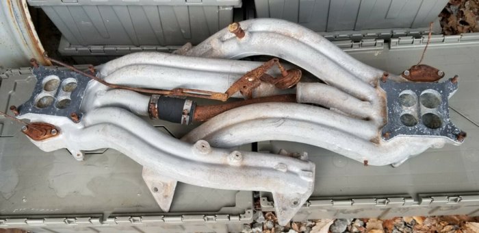

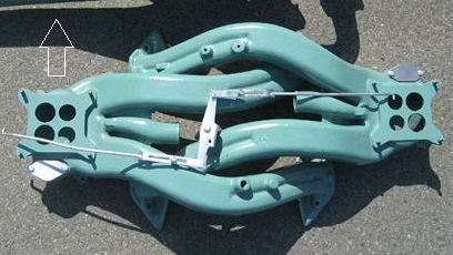

There is the Long Ram intake (30” (762 mm) long runners) – which makes max power at 2,800 RPM.

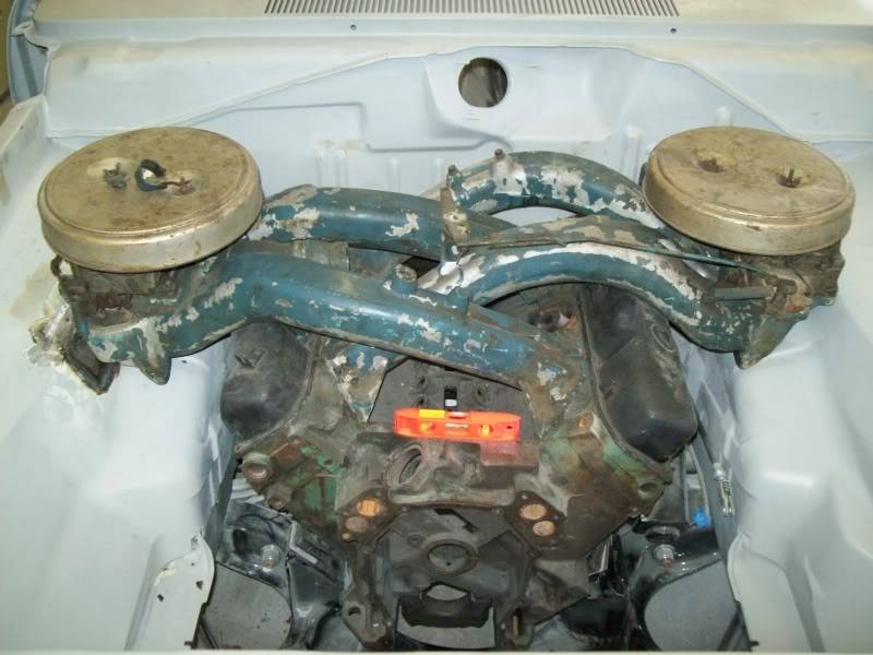

The (Short) Long Ram intake (15” (381 mm) long runners) – which makes max power at 3,600 RPM. Another picture is on this thread, post #4 (in an A-body).
You can see the full runner length on picture above this one. This one has more of an elongated plenum.

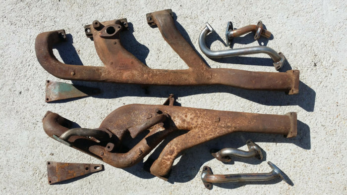

I have a pair of ’61 long ram intakes, p/n 1947162 and 1947163. My intakes are exhaust heated and corroded to the point the previous owner cut off the exhaust heated section of both intakes. The fueled section is all in great condition. My plan for them is to run with dual 4-bbl appearing fuel injection units – so the exhaust heated portion won’t matter as much.

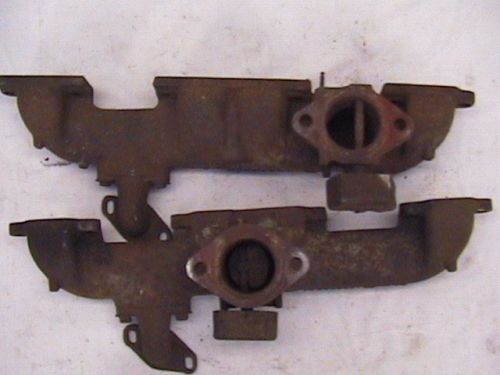

The earlier long rams used log exhaust manifolds:

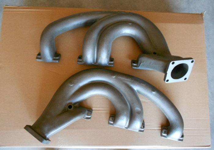

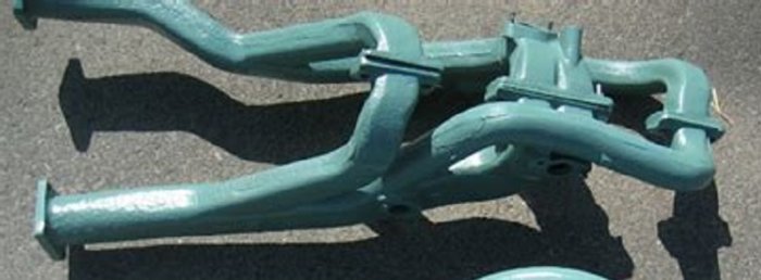

The newer ones used these beauties:
I would LOVE to see these repop’ed for this would make a wonderful big block manifold.
Note: both versions has provisions (bosses) to allow for intake heating via exhaust.
In my garage is a (repop’ed) set of Max Wedge exhaust manifolds – but these exhaust manifolds and Long Ram intakes both want to take up the same real estate.
I’m building both of my big blocks for low RPM torque monsters (for street usage) and it would be fun to stick a set of Long Rams on either my Volare or Fifth Ave – but I just don’t see them fitting (or the Max Wedge exhaust manifolds, either) without getting out a large hammer and/or a torch.
