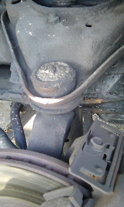

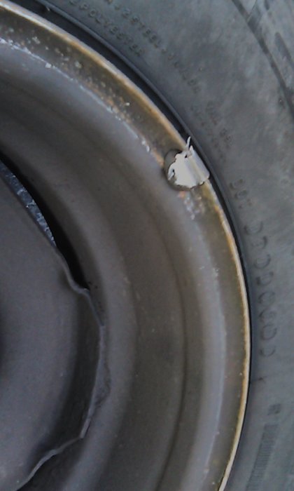

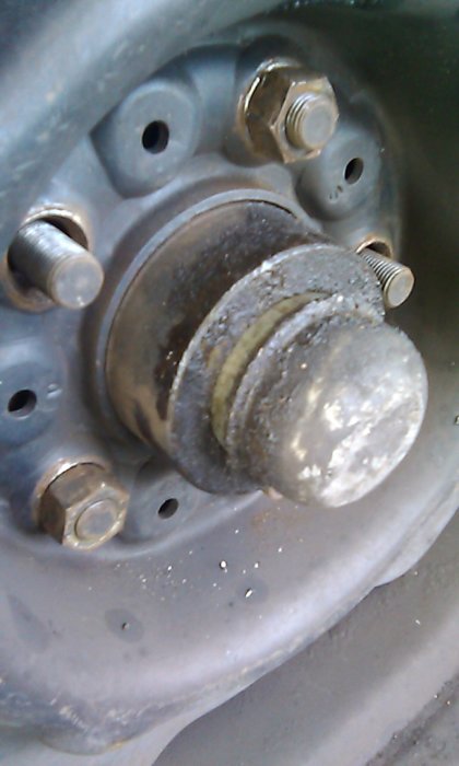

Ok, I've got some pictures to put on here when the phone is free, I've got to say it was very easy to take the brake apart, getting the caliper back on wasn't so easy though. The spindle looks ok, no obvious damage. I'll post the pictures shortly
