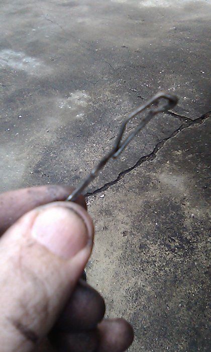

Is there a special type of wheel bearing grease these car use or will any wheel bearing grease work? I was planning on replacing the cotter pin anyway, it looks like it was used and poorly bent back together (see picture two posts down) the brakes were last done by that New Haven mechanic...
