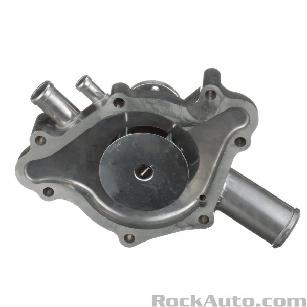

BudW, if I understood correctly it would be a safe bet that a 318 water pump from a 1981 or later M body should have the bigger bearings and they were all AC?
Remow2112
Mar 10, 2011
169
48
Rockauto for a 1985 Dodge Diplomat show a Hi performance water pump for $50 AIRTEX AW7103H. It has 6 blades and an anti-cavitation plate. I will probably run with this and the smaller pulley.
This was a much deeper rabbit hole then I expected! LOL

For long term use or for driving hard (like I like to do), I would HIGHLY recommend the newer pump with larger bearings. That said, one can't discount the blade count differences.
After '82ish (not sure of the cutoff), all of the non-A/C cars used the same pulleys and brackets - but have an idler pulley mounted where the A/C compressor is at (on non-A/C cars).
