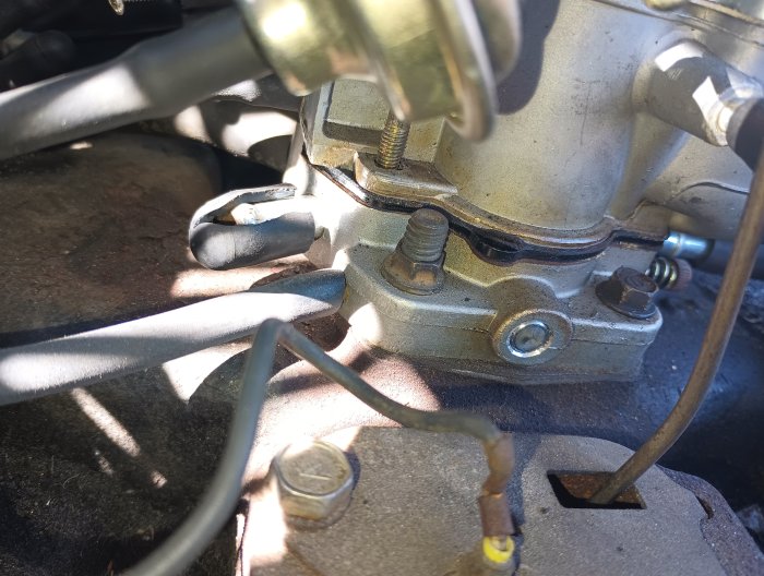

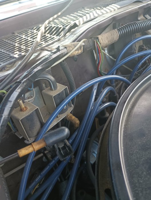

a recent issue I'm having. made worse by the weather fluctuating here. i diagnosed a vacuum leak which helped but still, when starting the car and first putting her in drive to drive off, almost always unless it is burning hot outside the car will stall. throw her in neutral, start, drive, we're fine. she'll also die on sharp turns when not at full op temp. hidden vacuum leak you think? i need new spark plugs? or should i get the carb retuned? i do have this mystery vacuum hose that doesn't seem to go anywhere that could be causing an issue. i just capped it for now. the vac leak in the second pic has been fixed. thx

First thing: properly plug the broken plug at the carb.
That's a 1A air leak.

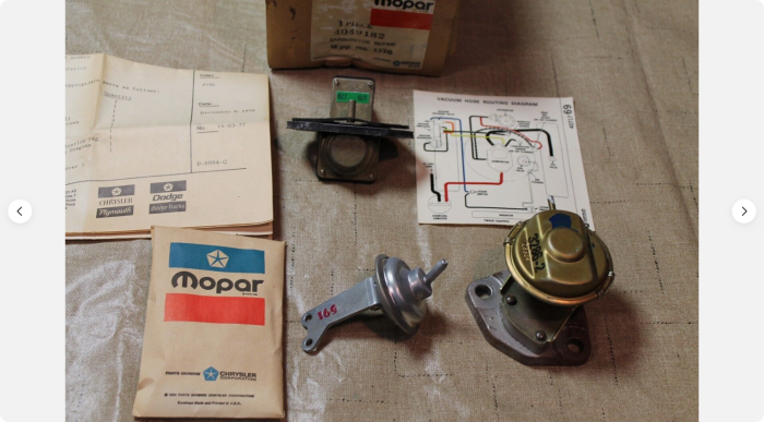

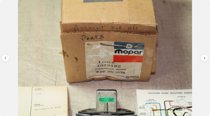

Do you know what year BBD you have or the numbers on it. Early in the emission years there were several TSB-s for exactly this and also some mopar kits to change the things needed to cure the issue.
Driveability Improvement Kit​
