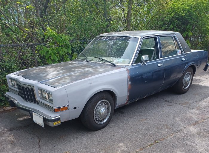

Here's my rust free rustbelt monster:

Ethanol free gas is very hard to come by in Maryland and its normally only at boat docks. i'll try and find some B-12 and let you know. can seems a little nicer now that its warmer out but still that hesitation taking off from a stop where i held the brake for a while. giving a lot of thought to Holley EFI. i have a 2300 system in my closet waiting for when i get sick of carburetion. like dude, it makes a 2bbl sound like a quadrajet! Frankendip looks good

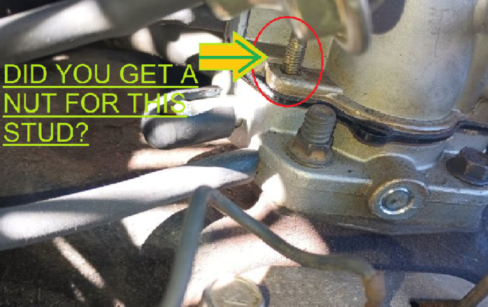

As much as I loathe Chinese carburetors, they're cheap enough that as you wreck them with ethanol you can just slap another one on there

You dont need all 4. They gave you extra in case one fell off the U-Joint strap
