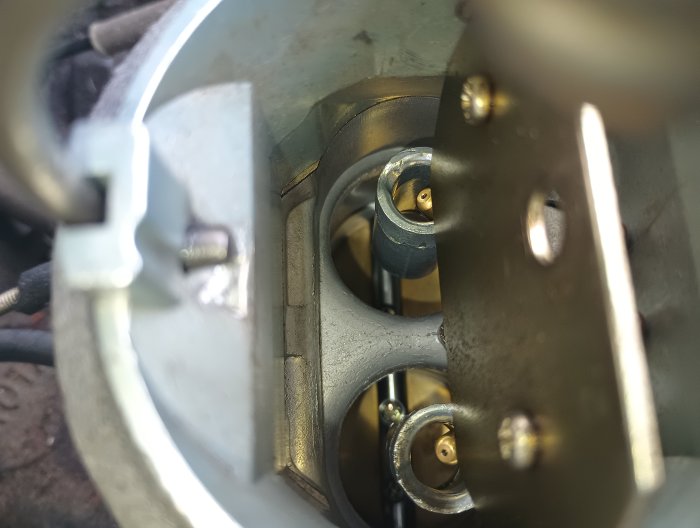

With a small Carter you can remove the top cover (together with acc pump and choke rods) and watch the float level while running the engine. :cool:

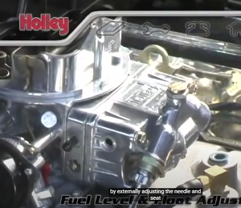

is this config fairly universal. turn the screw till fuel just barely drips out of the sight hole?

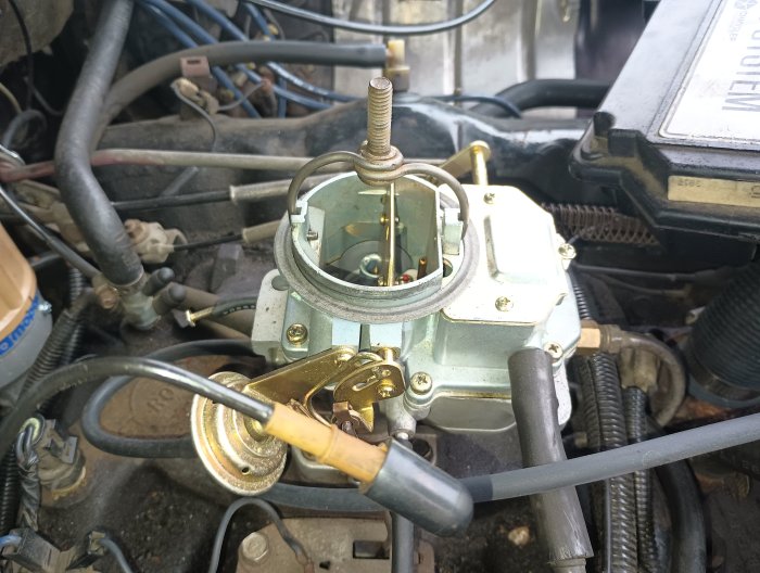

backing out of a spot yesterday. thing would die when hitting the gas to reverse. car kinda shakes and bogs out. after a few restarts she did it fine and got me home. after being on the road a bit shes fine but when started from cold is when she hates me. drive or reverse she'll die when put in drive and i go to hit the gas. its only after i hit the gas she'll shake and sputter out. sometimes just a little bit of hesitation after going again from a red light but i have sat in stop and go traffic with no stall. these stalls have come after a long warm up on cold days even though i made it through the dead of winter driving to and from work with little to no problems so i don't know why shes doing this now that it is warmer out. still think it is the float level?

Have you checked the choke?

seems to open and close fine though it is most often open just a tiny bit. my old 6280 was stuck open all the time. perhaps i should start from now on with the old pen trick?
If it's only opening a little bit, even when the engine is hot, the choke pull off isn't working or the choke thermostat has jammed the choke. It should be wide open when the engine is hot. Otherwise you're running rich and flooding it at hot start ups.

just checked again, it is fully open. it is 70 degrees out. i was remembering looking at it when it was dead of winter, thats when it was closed halfway normally
Hmm, maybe it likes a little choke because it's an old engine. You can mess with it and get it to close a little and see if it improves. The link in my last post covers it better than I can

I think you have an issue with the choke and an issue with the fast idle setting. If you get a service manual it'll walk you through it. You can substitute the goofy special chrysler tool the manual recommends with a flat head screw driver and your eyeball

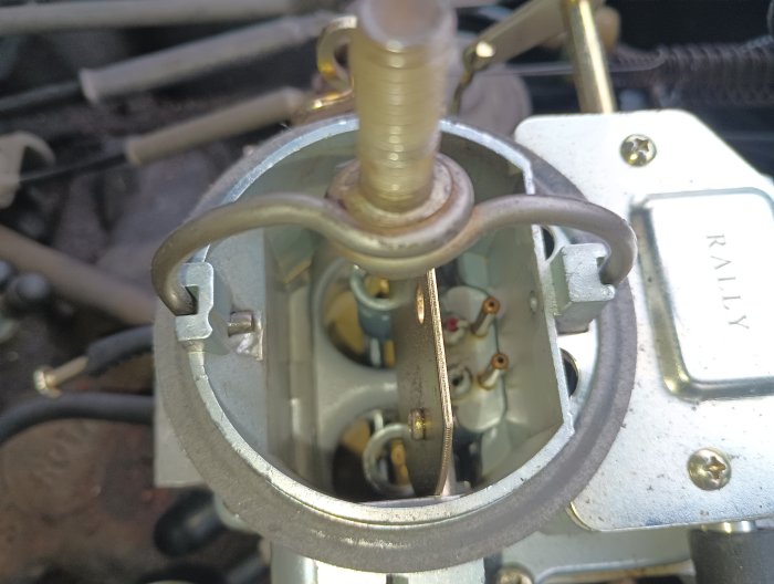

With the lean burn deleted, that vac line might not go anywhere now. Adjusting the choke pull off spring and idle really is just a couple of screws and bending a "spring" that is more like a clip
It does look like you have the choke thermostat off the Holley. I think the arm is too long on those, you might have to get a choke thermostat for a Carter BBD
