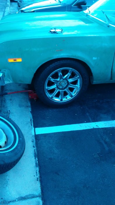

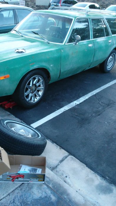

Picked these up with 4/32nds tread left for $120 with the center caps included.

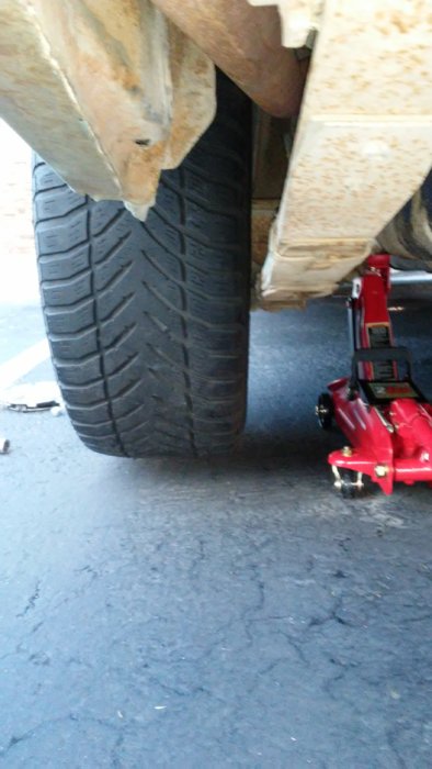

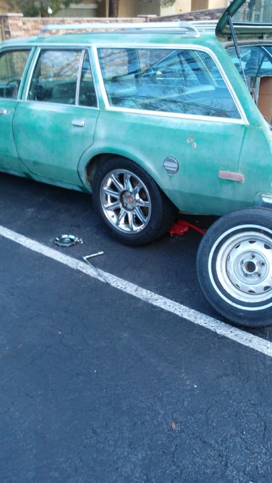

This is with the stock tire size on the LX wheels 225/60r18 which is a tall tire! I didn't have the right lug nuts, so I couldn't torque the wheels down and drop it. But they fit! About 1/2" clearance from the leaf springs. I'm thinking about a 235/45r18 all around. Which is almost exactly the same as the 215/75r14 on there now. I'm hoping that the stiffer sidewall of the 45 series tire will make that 1/2" clearance manageable.
The reason for the 18's is strictly due to cost and quality of tires. I daily drive my wagon in Las Vegas, which if you have ever lived/driven here you would know how crazy everyone drives. I'm really looking forward to increased cornering stability and higher quality tread compounds.

They look great, the 1/2" should not be a problem but if it is a 1/4" spacer will fix you up. The only thing is I think the pattern on the wheels is metric and off just a bit from 5 on 4.5 bolt pattern of the car.

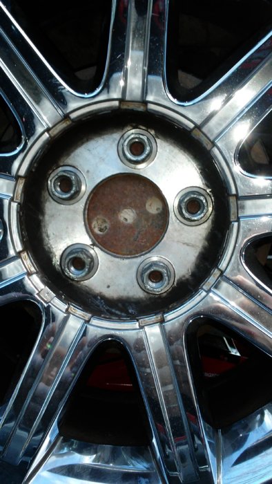

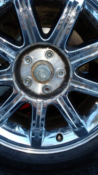

Took them to a tire shop to verify 5x114.3 which is the metric equivalent of 5x4.5! They center on the hub and the lugs are centered on the lug hole/bore.
If I had the right seat on the lug nuts, I think I would be driving them now. Gonna replace the wheel studs and go a little longer in case I need a spacer. Then ill upgrade to the bigger rotors from a Cordoba.

Ive been curious about how the modern lc/lx wheels would work on our FMJ cars. I'm still stuck in the 70's-80's wheel designs, but these could work. My concern is the wheel offset. It looks like they darn near do. Any narrow spacer should ease your mind on sidewall rubbing the spring. How was clearance on the front? They look good and right in the pictures. I thought they'd be sucked in leaving a narrow footprint, but they look good. I'm interested in how you progress with the wheels. Keep us posted in your progress.

All of the new Charger, Challenger, Magnum and 2006 (and newer) Chrysler 300’s “should” have a 5x115 mm (5x4.53”) bolt pattern – but I have also heard some of the early ones (2006-2009) were 5x114.3 mm (5x4.5”). I have not actually measured the early ones to know for sure.
The newer ones (2010 and newer) I do know for certain are 5x115 mm.
If they are 5s114.3 mm – then I would crank the steering to both extremes to check for tire contact to frame. If contact is present – that wouldn’t be a problem in most cases (just need to remember that fact when driving in parking lots).
The space between rear tire and leaf spring is a bit too close for my liking (from picture).
BTW, the leaf springs on FMJ cars are mounted at an angle. The front of leaf springs are a different distance apart than the rear of leaf springs are. The reason I bring this up – is you need to look at distance on both front and rear (of rear tires) before making a decision.
For the picture you shown, I would feel better with a 1/2" spacer installed (or to use a 5x114.3 mm to 5x115 mm adaptor if wheels are different).

LX cars are 5x115. 5x114.3 will bolt on and many do it. The cars bolt pattern is 5x115

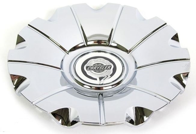

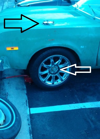

And as a personal question from a very novice fmj owner, what is that silver disc on the driver's side of your car?
1,494
It is the pop-on wheel center cap (hides the lug nuts), for the Chrysler 300 9-spoke wheels.

I do highly recommend checking distance between rear tire and leaf spring on both the front side and rear side (a camera works good on front side of spring, when looking upwards).

oh good grief ...
and here I thought he put some access panel on the hood of his car.
Don't tell my husband... it will confirm his suspicions that I don't know what I'm doing.
Thank you Bud :oops:
