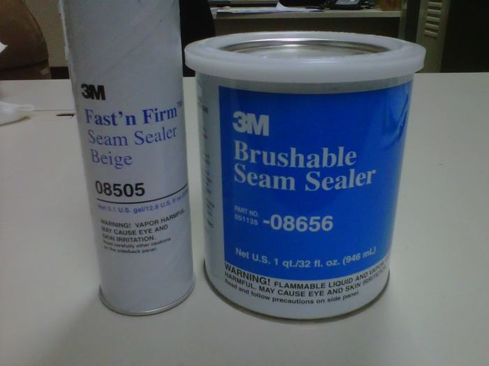

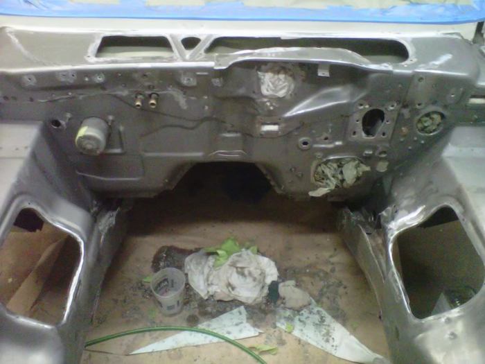

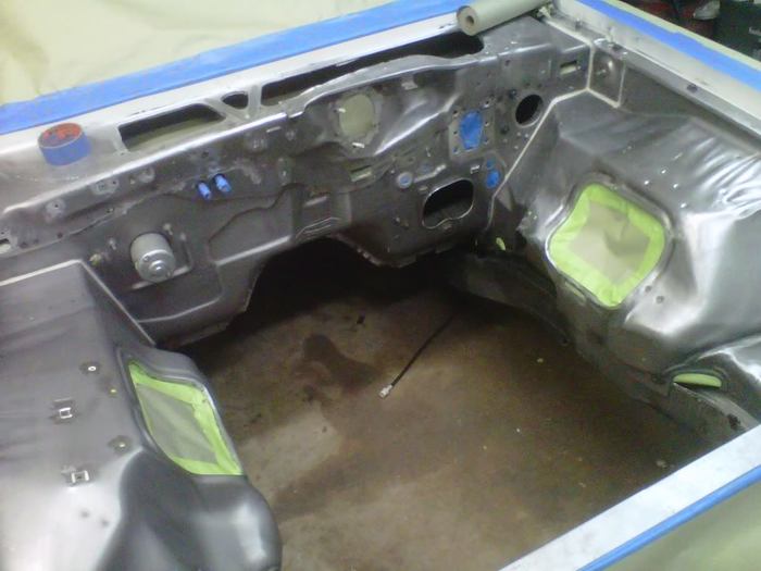

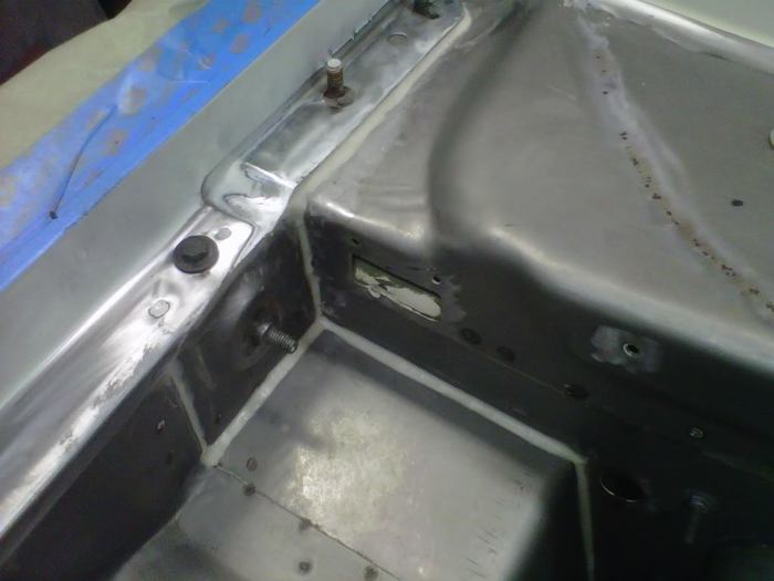

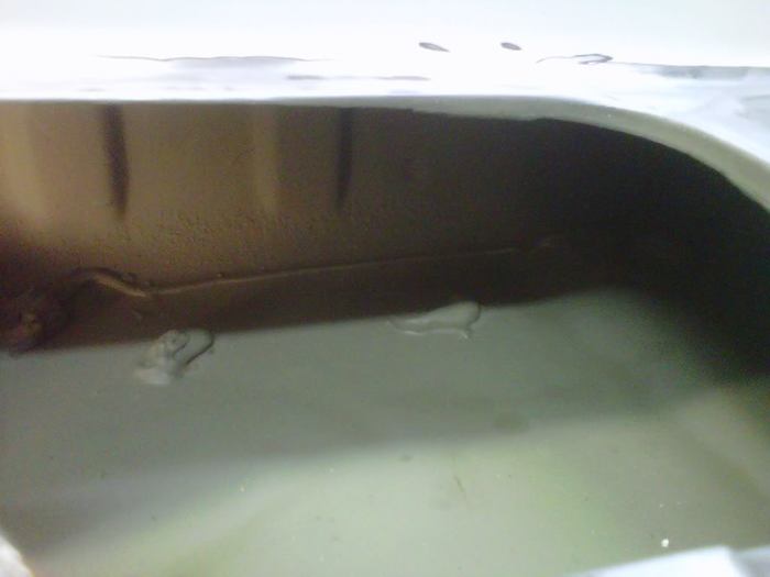

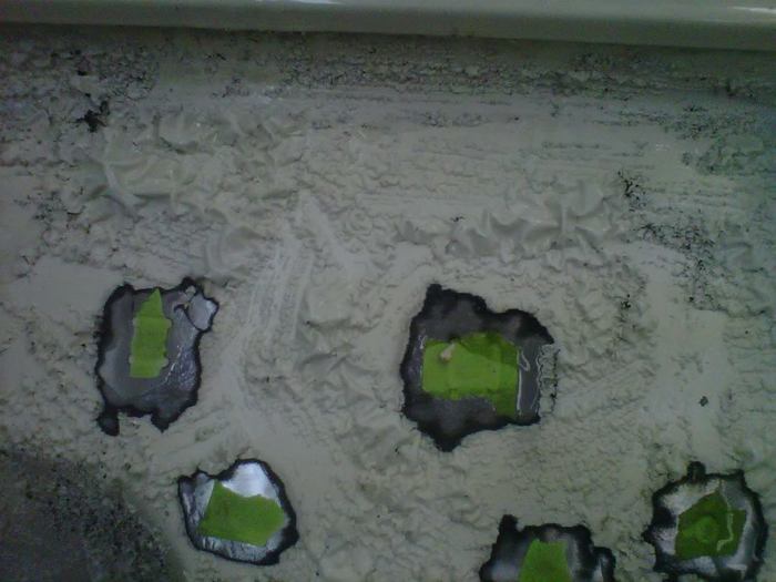

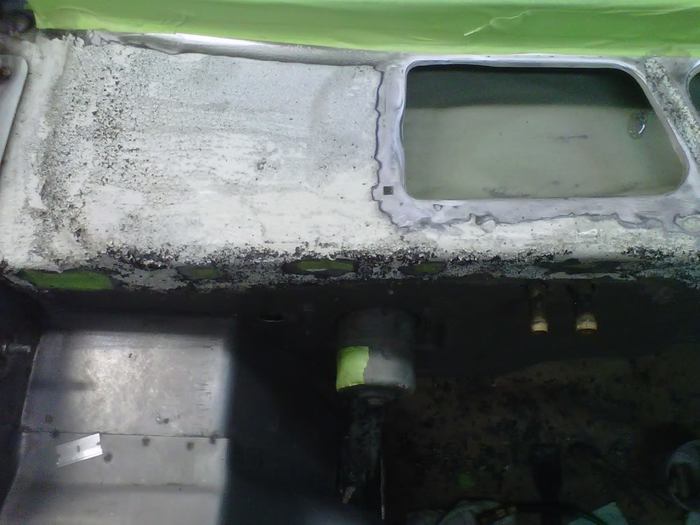

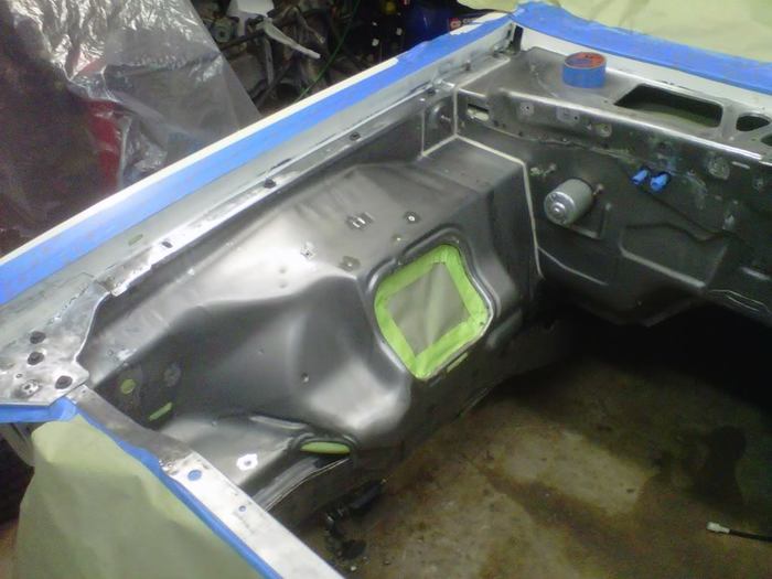

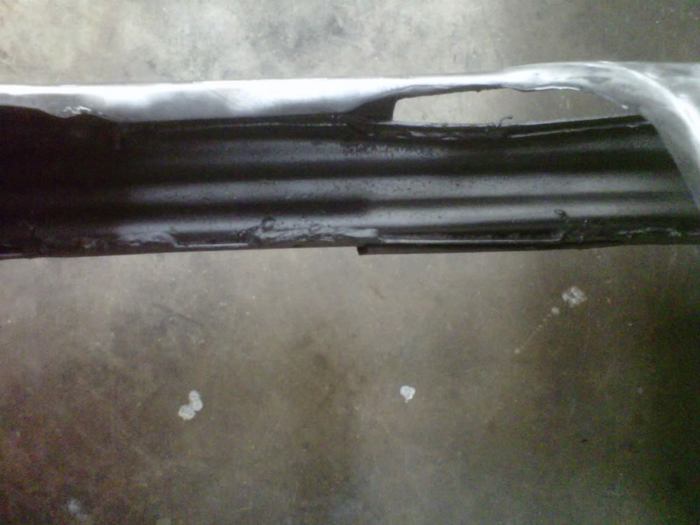

looks great under the hood. The way you did the seam sealer will definitely clean up the look under there instead of the cow pies which basically served no purpose. I find seam sealer all over the car but sometimes not where there should be some. All of mine is dried and cracked wherever I have been poking around except for some areas in the trunk. I will be replacing it all with the brush on and caulk I bought at eastwood. I will prime mine first as the seam sealer sticks well to primer. I just want the added protection as most of the original was done directly to the metal and once it cracked and came off it was bare metal. I think the new stuff will probably last forever compared to the old stuff though.
