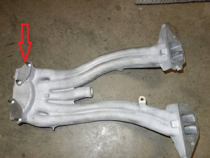

There are two different versions of aluminum 2-bbl /6 intakes out there.
The ones used for the feather dusters (A-body) – Chrysler took the cast iron molds and used it to make aluminum versions, out of (early to mid ‘70’s). I don’t “think” any of these got used on F-bodies (could be wrong, though).
The newer version aluminum intakes were a two-piece design that is welded together. I hadn’t weighed them – but the 2-piece design is a tad lighter than the older one-piece aluminum intake.
I think the two-piece version came out about ‘81-82 (maybe) and was used until end of production.
If a person is getting a super six intake – it is highly recommended to get all of it (carburetor, throttle cable, kickdown linkage, choke, air cleaner and exhaust manifold) – as an assembly.

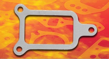

Chrysler aluminum intakes do have a pitting problem where exhaust gasses makes contact to it.
I’m not aware of any other problems with /6 aluminum intakes – except for where it attaches to the exhaust manifold.
The sorta square flange (above) where the Intake meets the exhaust, sometimes you will have pitting where the gasket touches the intake. If you have that problem, you can take intake to a machine shop who can machine a bit off - just enough to remove the pitting. Then just use two gaskets (2x) when bolting the manifolds back together.
The exhaust heated Long Ram intakes and (high mileage) street Hemi's have the same problem with pitting.
