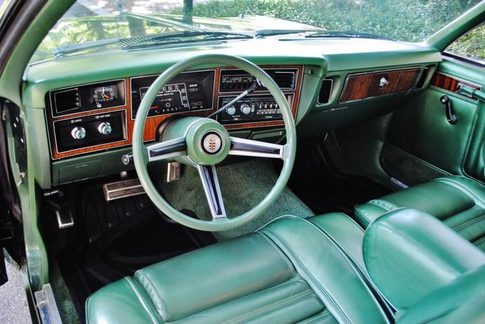

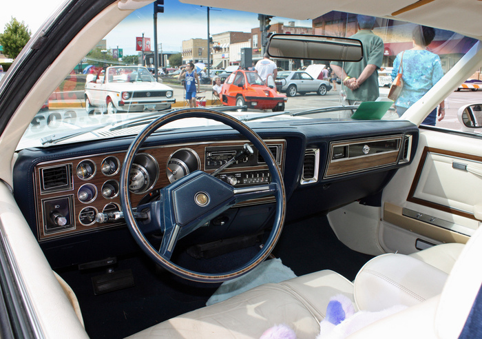

Hmm.... That's interesting. Got these pics from the internet..
1981 Dippy
Dodge Aspen
I can see where using the M body dash would be nice. Get rid of the stock gauges and insert a nice aftermarket tach, speedo, gas, oil pressure, etc.

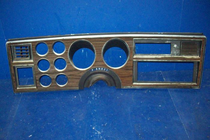

MY question is "Can the Instrument Panel (NOT the entire dash) be swapped from the M/J into the F?"

You just need the plastic carrier that holds the gauge cluster / HVAC controls, and the radio from the M to put into the F. The carriers are different, because the gauges are different. Plus you need the wiring harness, or as much of it as possible from the M, because your F connectors will not directly fit the M gauges. In terms of a J body, I have no clue. It looks radically different from an F, and and M.

This is all I'm talking about. I can see just swapping this into an F body using VDO or Speedhut gauges. Those 150 mph cop car speedo's are a little thin on the ground. This looks like a nice possibility.
