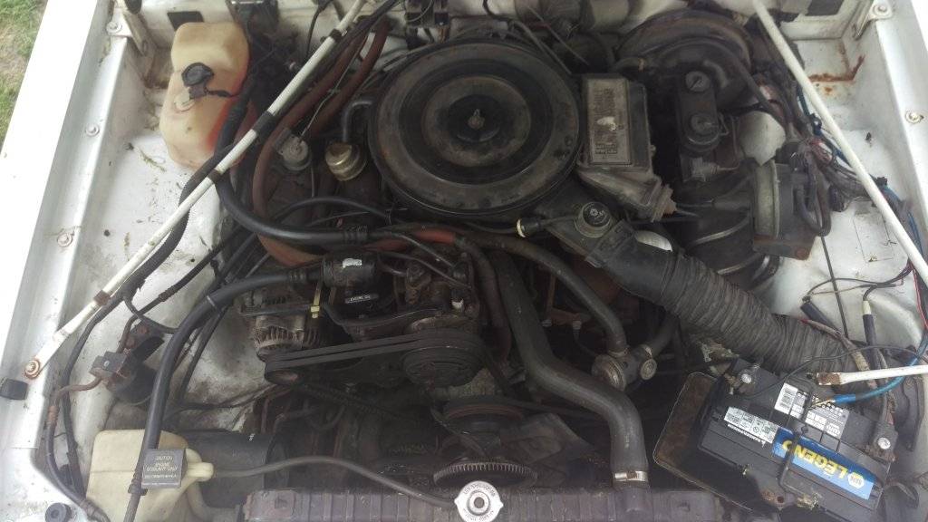

Before. Basic lean burn, nothing fancy.

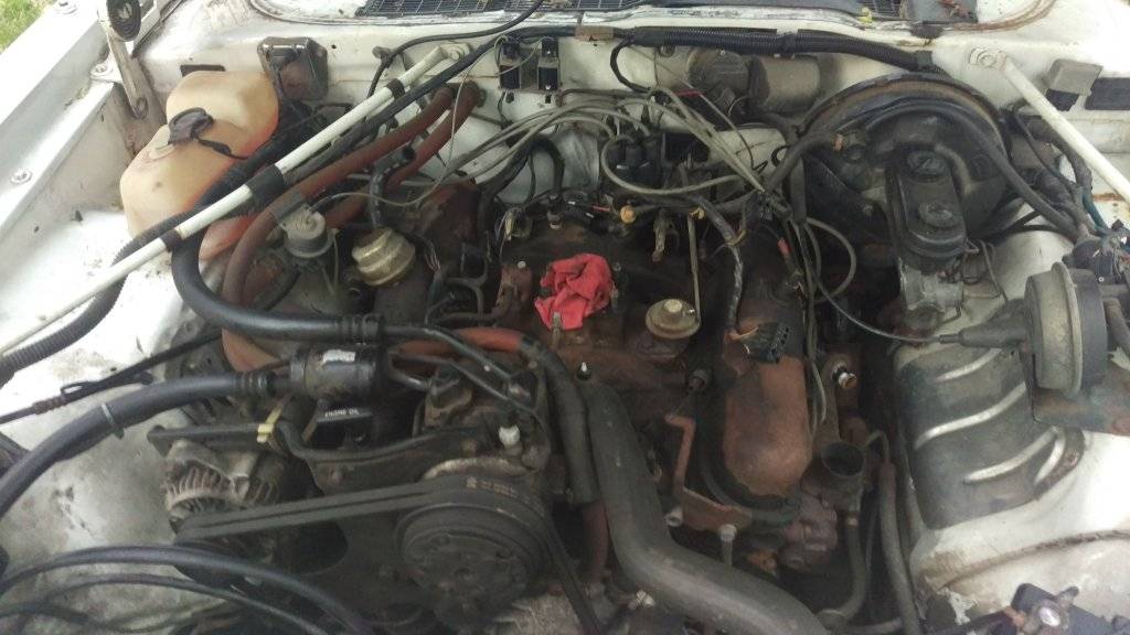

First most obvious step, removed the air cleaner and computer, along with a bunch of vacuum lines.

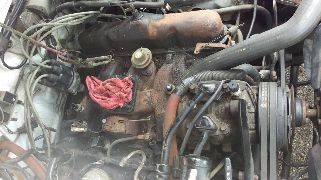

Carb off, holes stuffed with a rag to keep varmints and wayward nuts and bolts out. Also got rid of the old air pump hoses.

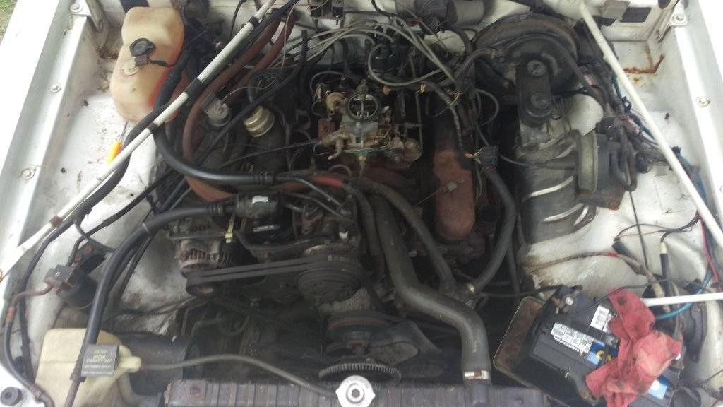

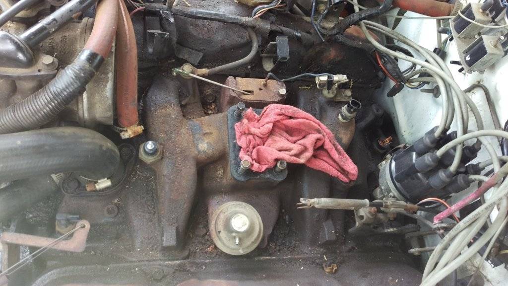

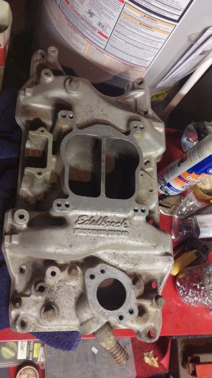

This is the intended donor intake.
Again, not getting fancy, my understanding is I can run a Pertronix Ignitor with a vacuum advanced distributor and a stock coil?

I'm doing the exact same thing this week. It's taking longer as I'm painting parts as they come off.
I went with: Weiand Action+ Intake, Street Demon 625cfm Carb, Rev-n-nator ECU, Firecore Billet distributor, matched coil and NGK spark plugs.
Now, if I can just get that old intake manifold off! Any ideas how to break that 38-year-old adhesive?

I was looking at the Street Demon as well. I'm not as concerned about mismatching parts as I am simplicity and price.
As for breaking the old one loose, maybe a pry-bar and a 2x4?
1,492
A big hammer tap the edges. Its real heavy you may need a second set of hands to lift it up.
I second that motion.
Generally the "light tapping with a heavy hammer" is all it takes.
Do not pry on it, or YOU WILL BREAK THINGS!
You might need to remove a valve cover for it to come all of the way off. The Right side is much easier to do, because of the hidden bolt under the brake booster.
Use a good gasket set, the two end rail gaskets have a tendency to come loose and leak oil at either end, of not installed correctly.
Might not even be a bad idea to have a second pair of hands when installing it (without anything attached to intake, that is).

Well, it helps if I take ALL the damn bolts out! That's what I get for spreading the job out over a few days. I must have had ADD that day since I left 2 bolts in.

Well yeah, if there are still 2 bolts attached. Don't FORCE it if it isn't budging, I usually just get the end of the bar wedged under it and twist. Never broken anything yet. If it's stubborn I find a tab and GENTLY pry on it, once it gives it's easy to pull off by hand.

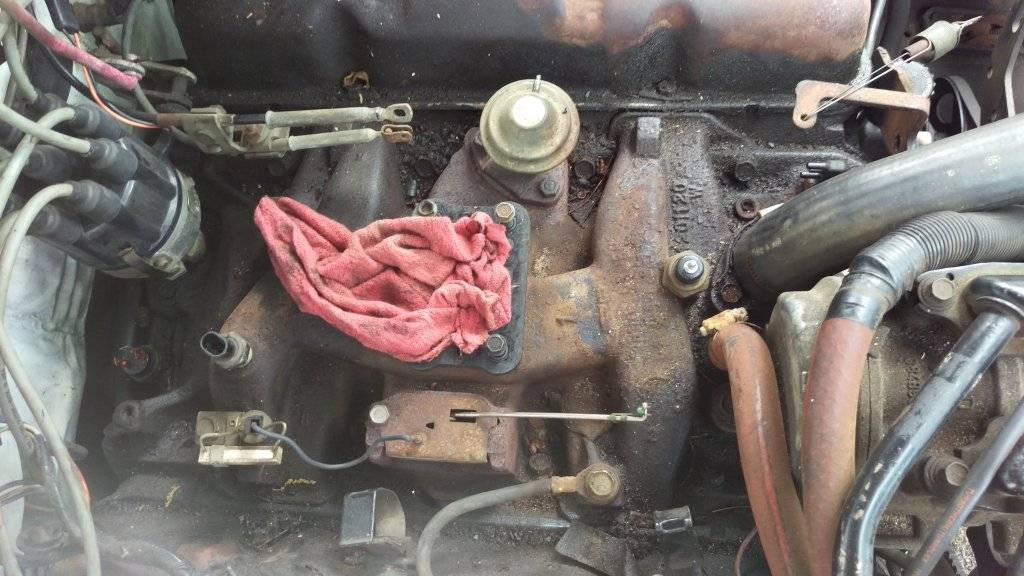

Cleared away more of the wires and lines
Not too bad once the clutter is gone
The biggest pain will be the A/C compressor, but even that isn't a big deal.
