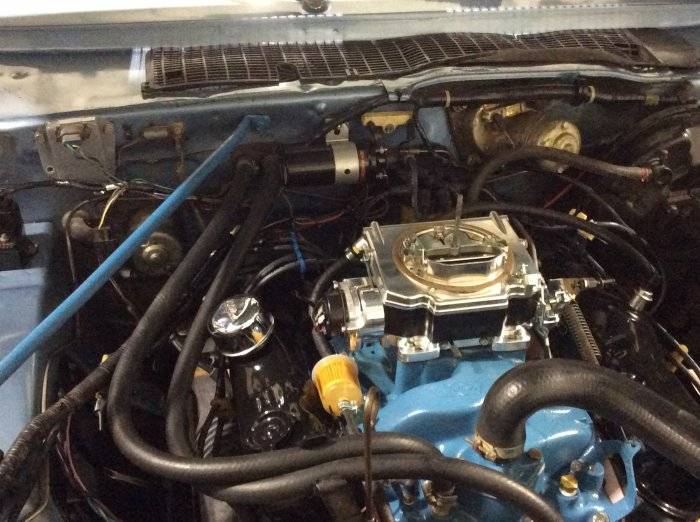

Somewhere between ‘79 to ‘84 (not sure when), Chrysler moved the ignition coil from the intake to Right side (passenger side) inner fender close to the firewall.
I took pictures of the area on my ‘77 Volare and of my ‘86 5th Ave. The later picture is hard to see with the A/C hoses and other items in the area - but you can see the coil is under all of those items.
Before installing the new air cleaner, you may want to look at your old ignition coil and see if it will fit in that area, first.
If you plan on driving car over 30 MPH much, then you will not want to remove the outside air hose (it gives you about 1-2 MPG at highways speeds).

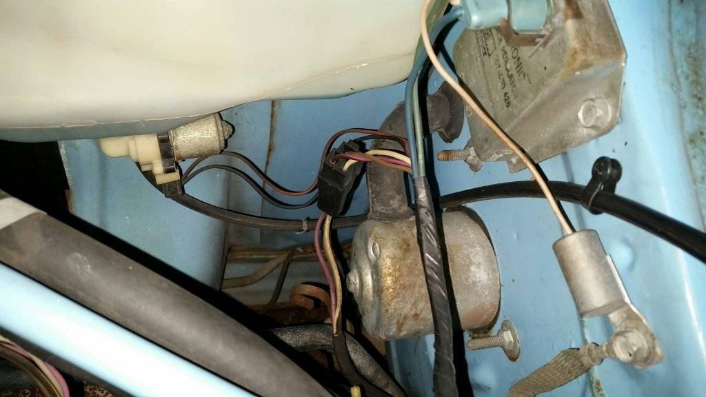

Under washer beside blower motor ('77 Volare).

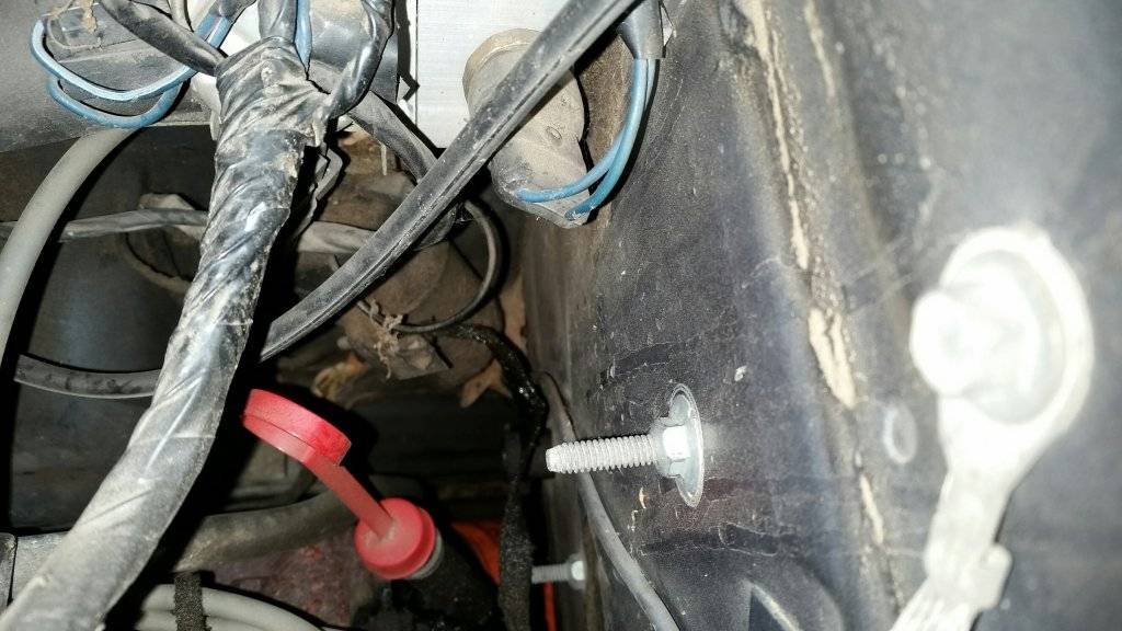

Same area (see grey coil wire). Ignition coil is dark but is underneth A/C expansion valve,
