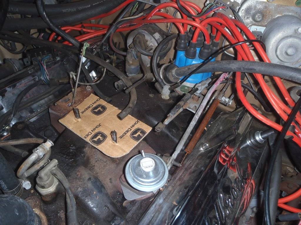

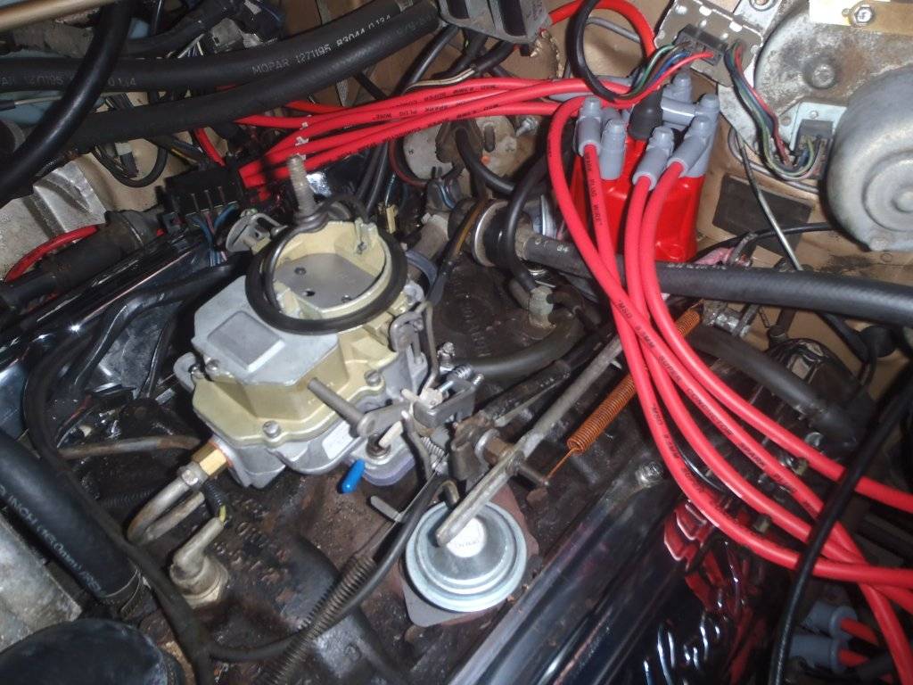

I just did the swap. Needless to say, she runs much better than before. I'll include some pictures.
Oh, and I did also leave the computer bolted to the air cleaner.

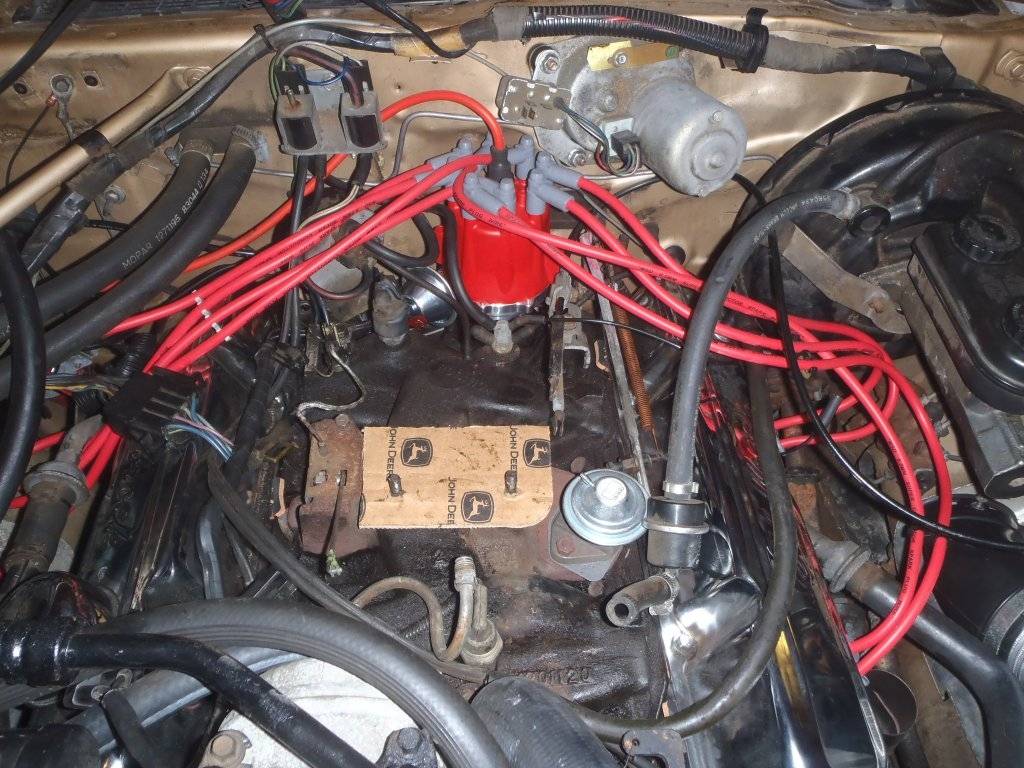

Is that the MSD all-in-one distributor?

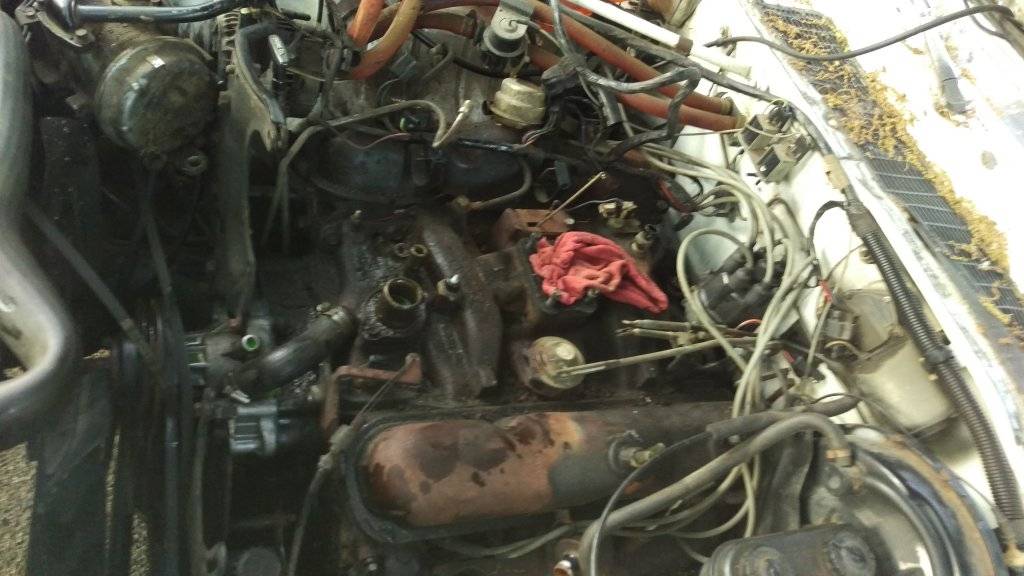

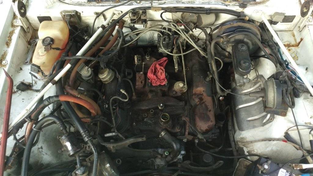

Got a little more done, moved the A/C compressor out of the way,
Was a bit snugger fit than I thought, but just had to undo the heater and upper radiator hose at the intake and wiggled it out.
Still love how much sense these cars make to work on if you just stop and think a minute, everything all falls right into place!

yeah it's the MSD ready-to-run for small block Chryslers. Installation couldn't have gone smoother. Only 3 wires to hook up, and it comes with everything needed. I bought it from summit. Pretty expensive, but you get what you pay for.
http://www.summitracing.com/parts/msd-8388/overview/make/chrysler
I had already installed an MSD blaster coil about 2 years ago when I did a tune-up. I decided to stick with MSD since they have a good reputation. I did put a set of their wires on too because they use a male/hei style cap. Also, the coil to cap wire that came with the wire set was too short, so I just modified my old one. Haven't had any issues.

Next most logical step is to drain the oil and coolant. Very important, don't ask what main bearings look like after forgetting this step and launching on an 800 mile straight drive...

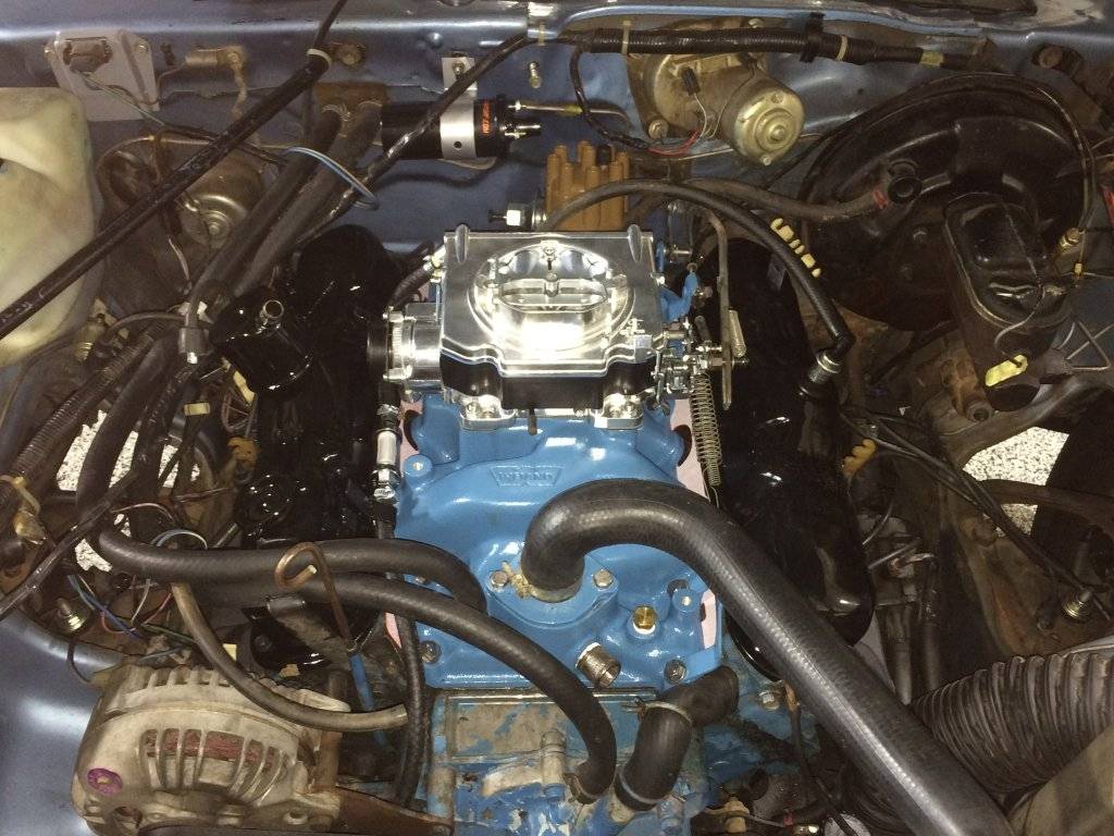

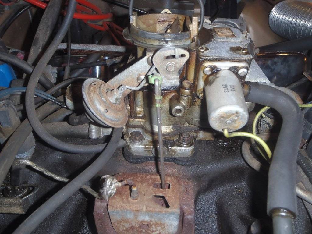

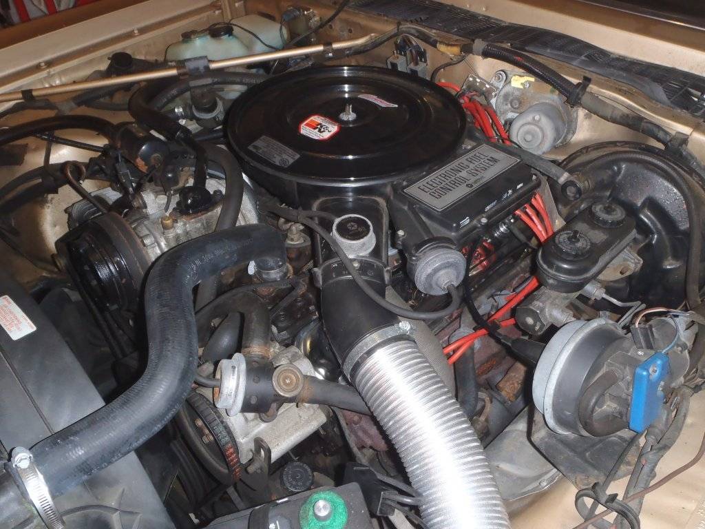

Slowly, but surely, I'm getting there. I hope to have it fired up this weekend. One note, if you go with Rev-N-Nator, you have to buy a pigtail for the ECU.

I have one Rev-N-Nator setup (need two) - but hadn’t installed it yet.
Was disappointed when they said they don’t recommend using it when using vacuum advance (I said WTF) - so am curious to see how yours work.

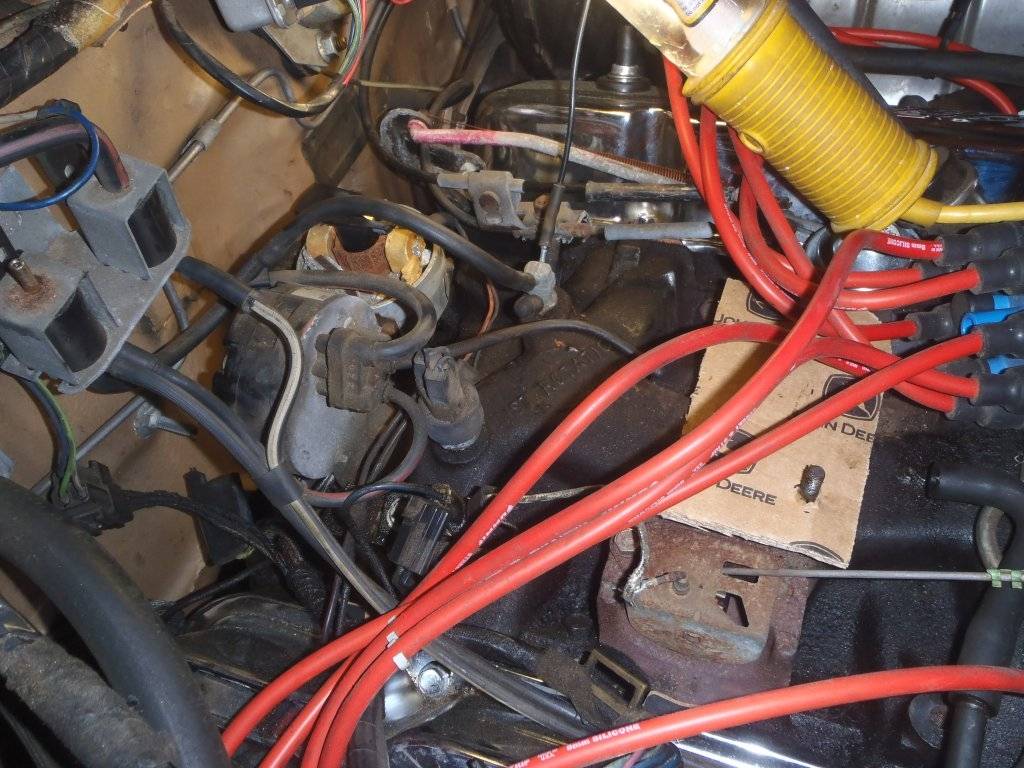

There's something much extra wiring that's not needed now. The photo was when I had everything pulled out of the way.
I started it this afternoon. Now I'm cleaning up all of this extra wiring and going crazy with the zip ties and electrical tape.
One major problem is that the coil rubs against the stock air cleaner. So, I now have a Demon chrome one coming from Summit. Was trying to keep it somewhat stock looking, oh well.
