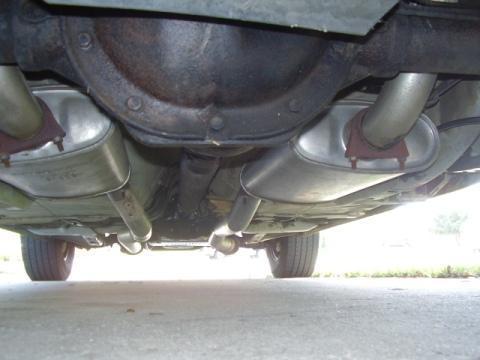

Alright, so yeah, you could do what the factory did, which is to run stuff into a single tailpipe.
OR
You could do what I did, which is to dump right behind the rear wheels.
Here is what that looks like from underneath:

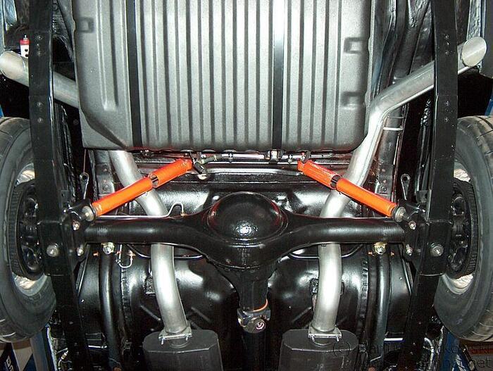

Always the option of moving the tank over a strap. Really easy if you use a tank without the hump in the top for the vent. I've personally ran the exhaust dumped before the axle, and just behind the tires. Always preferred running to the bumper.

I have my t-pipes both out the right at the bumper. The left crosses over above the axle. It's tight but 2 1/2 inch fits. You are right about a sway bar not fitting.
1,667
Huh? I've got a factory rear bar and dual 2.5" pipes all the way back. Everything clears just fine.
Same here. Move the tank over a notch, extend the filler with gas rated hose and clamps, and use 2.5" dual exhausts out to the bumper. So much better! I used Jegs A-body mandrel bent kit and mechanic did some mild mods but an exhaust shop could make one. My car is an '89 AHB but basically same configuration (factory rear bar). I got kit without mufflers and used Walker Quiet Flow because I didn't want any attention.

That is great for the non hump gas tank. Does not work with the hump gas. Tank. No bumping it a rib. :)
7,077
2,795
Should say, it won't clear mine the way they are. I built it using mandrel bends and pipe from Summit and did the cut and weld deal. Only took 8 million times under the car, measure, calculate angle, get out from under car, go to the chop saw, tack weld, back under the car...... Don't think I could do it now that I'm 12 years older, lol.
