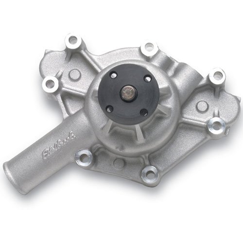

Anybody ever run an Edelbrock Water pump? Edelbrock number 8877? I’m thinking of picking up one and a Champion Radiator CC526. Thanks!

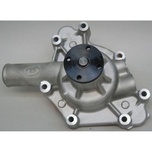

It’s been long rumored to be the same pump at approximately half the cost.
I run stock AutoZone replacement pumps in my DD.
On the street/strip cars I run the PRW, the pump will not cavitate (supposedly) at upper RPM’s. Plus there’s threaded heater core and thermostat bypass fittings (I don’t run a heater core or a thermostat bypass) which is safer than using those cheap rubber blank caps on a stock pump.

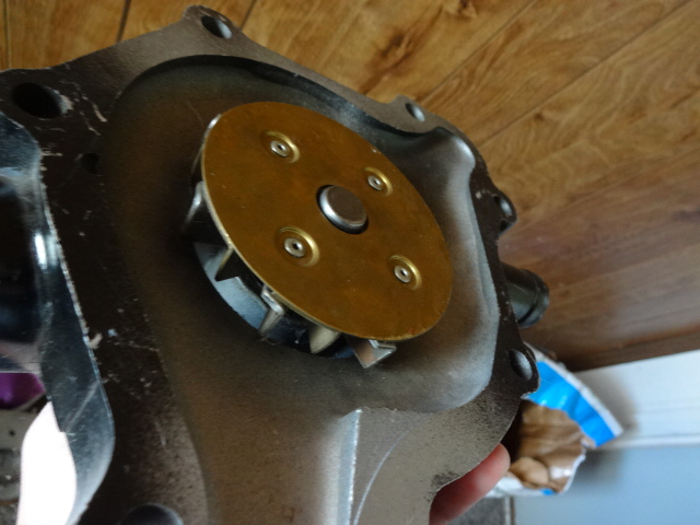

I use several of the older B cool pumps, alot like the flow cooler units but both now use a billet impeller vs a modified oem unit like in the pick below.

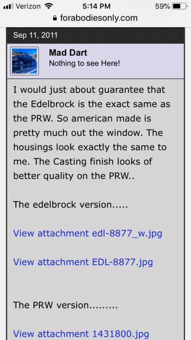

The edelbrock and the PRW are the same pump and from as much as I could tell the same guts, I have both, the edelbrock didnt last long the prw is going on three years of use and is a great option if you dont run a heater so you dont have the jacked up looking looped hose.

Speaking of the pumps with the anti-cavitation plate...I currently have the HD OEM piece on my ride, but I've wondered several times if I should yank the thing and put on the plate I picked up at a swap me (it's a kit, retained to the pump impelers with 4 rivets, sort of like the pic XfbodyX showed).
Anyways, has anyone done this type of a switch and have you found the anti-cavitation modification to work? Did the temp drop?

I’ve not seen that kit before.
The only thing that worries me is having enough space between the water pump and the timing cover. If a person leaves off a small block water pump gasket – the water pump impeller will rub against the timing cover. I would think adding a thickness of metal onto the impeller – might be about the same thickness as the gasket – which might lead to trouble.
