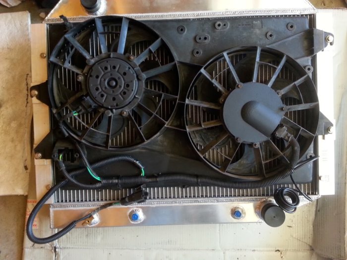

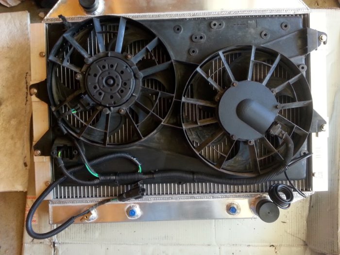

    Late 90's V6 Ford Contour. Perfectly fits 26" and could suck a horse through the front of the radiator. Fans are two speed if you want to use the low speed with a multi speed controller.

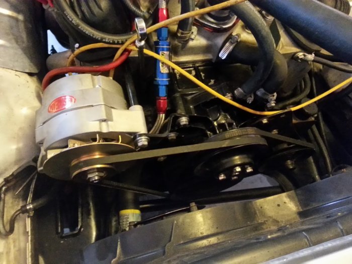

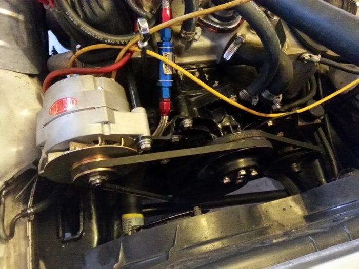

    My Dad made me some brackets to use a GM style 150 Amp Power Master. Internally regulated and I have a 150 amp breaker on the driver's fender for it. Works pretty good. Use a 60 amp maxi fuse for the power to the fans - this what was used from the factory for them.

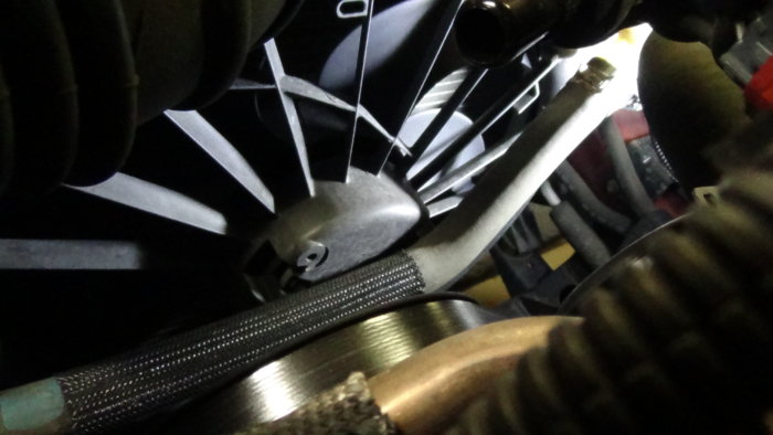

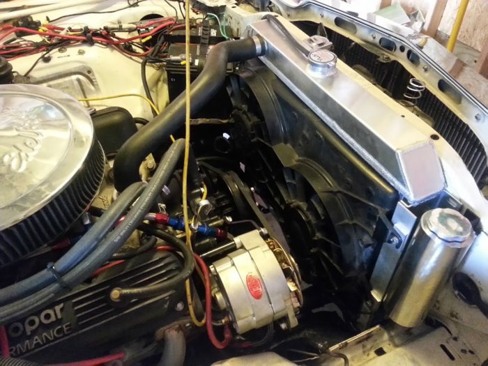

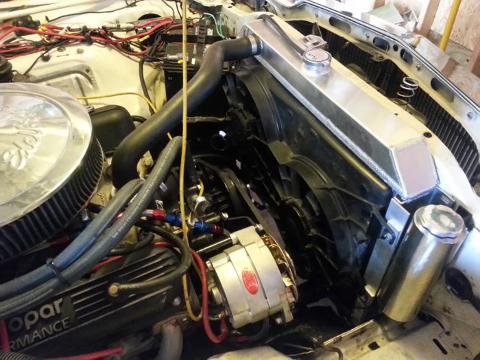

    Got pics, I was thinking GM 3 wire alt but hadn't had time to RIP into my car to see how much headache it would be
  8. Duke5A
    Duke5A Well-Known Member
    275
    89
    Sure, small block? After the big block swap I remade the bracket.

    The pics of the Contour assembly look to me like it would obstruct air flow at highway speeds, when you should never meed a fan anyway.
