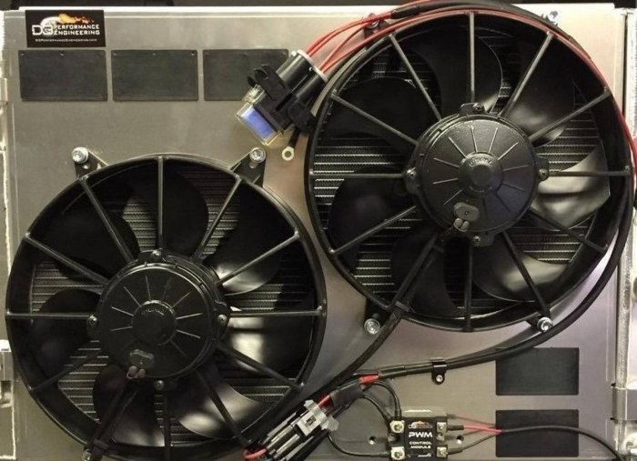

This is not your high performance cooling option. This here is $236 of ebay heart ache. (let me post this pic and then edit and add on).
Ive read some think aftermarket fans are junk, well a good many are but as well ele fans have come along way since there introduction.
I will post a pic of one of my decent ele setups tomorrow, its 2:39 am.
But here you have a quality set of HD fans.
I use fans like in this pic but I also use a louvered shroud for fan off flow.
SPAL fans, used in oem and aftermarket for years from HD implements to high end exotic sports cars then to my mealy junk.

No mention of the china man cooking up these fans. And I might add, although there are some puller fans that boast big cfm numbers spal fans are some of the highest flowing "restricted" fans.

I set my system up to live on one fan, but ive two. Quick cooling and by chance your one fan takes a dump, you never have to blink because you have a second on that can also do the whole job.
Simply wired through a t stat in the intake manifold coolant. Ive a couple small lights that come on when my fan/fans are and as soon as I reach a steady cruise I watch the light go out.
I also run a high end ele water pump, so in total im near $1400 in my one cooing system and that is also including the alt.
Like I seen in a pic here or close to it, a simple one wire gm alternator needs no special mounting brackets, ect.... its as simple as it gets.
