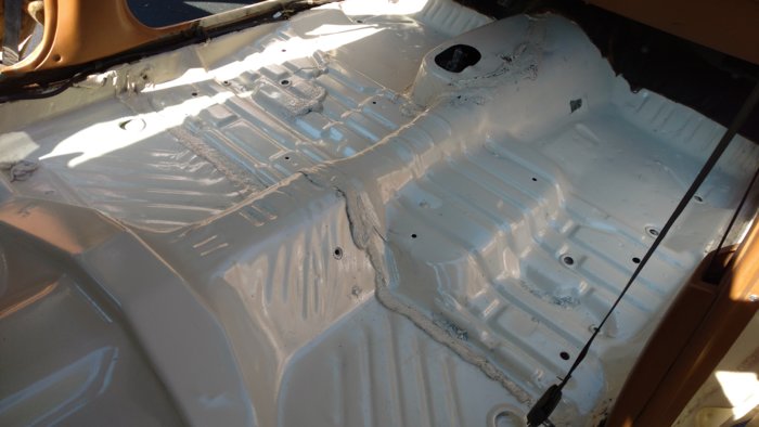

    In OY, the 60/40 seats fit work fine with the existing outboard holes from the former bench seat, and there were "dimples" in the floor pan which corresponded with the inboard studs on the 60/40 seats. I just had to drill them out. Not sure if they would be the same with the other seat combinations though.
    The original bench seat holes for the passenger seat are the larger ones just to the left of the black stripe (hanging seatbelt) towards the rear of the painted rubber plugs. The smaller inboard holes that I drilled out where the "dimples" were, are seen at each corner of the raised catalytic section. Wish I knew how to insert arrows on pics!

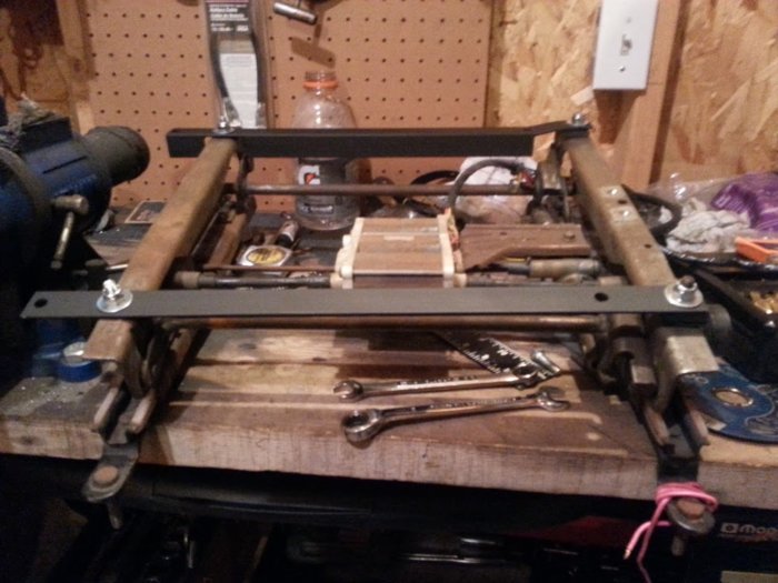

    Do you have 60/40 seats in the car now? Mine did and I converted it to 40/40 buckets by making some brackets out of angle iron to adapt passenger seat to the driver's seat rails. Seat needed to be shift over about 2" otherwise it hits the B pillar. Only draw back to this is it puts the recline lever on the right side. Might be able to move it - never tried...
