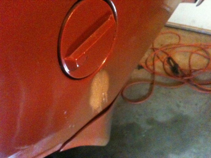

Filling tank with gas
Certain gas nozzles are a real pain. It ate the paint off when I cleaned it with the water at the pump. turn out to have something in it
That's one of the worst parts of having a side filler with just a cap (vs side fill with a fuel door), the chance of gas spilling down the 1/4 panel if you pull the trigger too much. I always try to listen and judge when it's getting full and release the trigger before the auto shut off. Times I've had the auto shut off kick in, are when gas spit out down the side of the car:mad::(.
I agree – but Not so much as for damage, but for wasted money.
On a different note, gasoline and diesel shouldn’t affect the paint originally used on our cars. I can’t comment about Ethanol damaging paint (not investigated it) – but for the most of us, you want to avoid using Ethanol to begin with.
Also, I can’t comment on non-OE paint types (no experience there, either).
Now some plastics used on our cars (mainly trim, spoilers/ground effects, M/J-body fuel door fillers, etc.) might be affected from gasoline – but not seen it happen . . . yet.
I suspect there was an additive in Billy’s fuel that wasn’t supposed to be there, maybe (spiked fuel?).
Gasoline has always had a negative impact on automotive aftermarket paint, Imron was the best for resilience to gasoline. Even under certain conditions it would wrinkle.
The times I've accidentally gotten gas down the side of the car, or truck, it's never done one iota of damage and both are not original paint anymore. The Aspen has clear that used activator and the Dakota is one step but it's also activated and supplied air respirator mandatory paints (isocyanurates, nasty) Of course, I clean it off as soon as possible and then rewax that area. Well, rewax on the Aspen and Mustang, the Dakota,,,,,,,,,,maybe yes, maybe no these days:eek:. At one time, it would be rewaxed immediately.

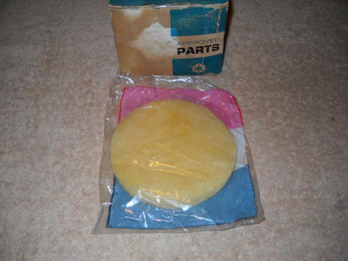

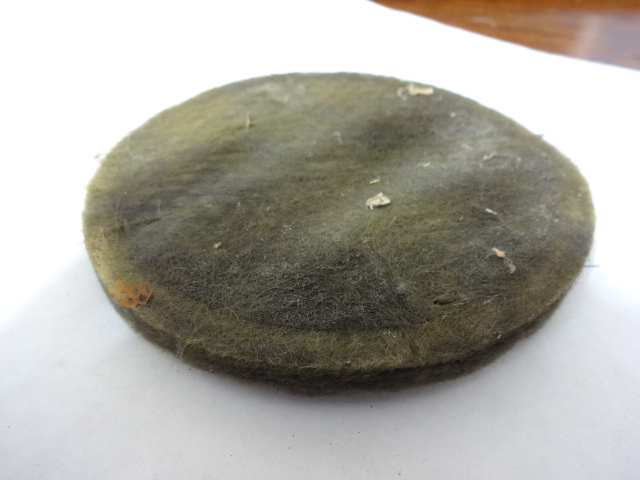

In reading this I thought id look at the bag for a charcoal can lower filter as most the time when they pop up they want to rape folks at $20 plus shipping.
Just nailed this mopar one for about 7.50 shipped and it says hes got 5 in the listing, well 4 now at best. If I were a flipper id of bought them all.
NOS Mopar 1972-1981 Plymouth Dodge Chrysler Charcoal Cannister Vapor Filter | eBay
If one needs one they might message him.

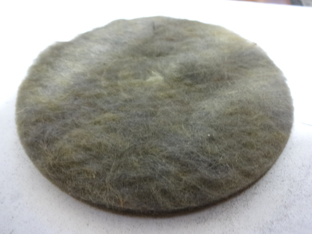

My old one was, well really old.

Those filters at one time were pkg quantity 5 to a white envelope. The bag doesn`t look mopar though but maybe they started packing them separate in the later years dunno. I have some around here somewhere.
Says listing has ended.
I wonder if those are actually aftermarket(?) Reason I say that is the bag says "APPROVED PARTS". Guess it doesn't really matter, just a thought.
They're still available aftermarket from NAPA, Carquest, Rock Auto, etc
