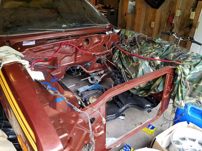

hey is that car stock with AC?
It had A/C at one time. not since I've owned it. That hump in the firewall is actually a PITA.
