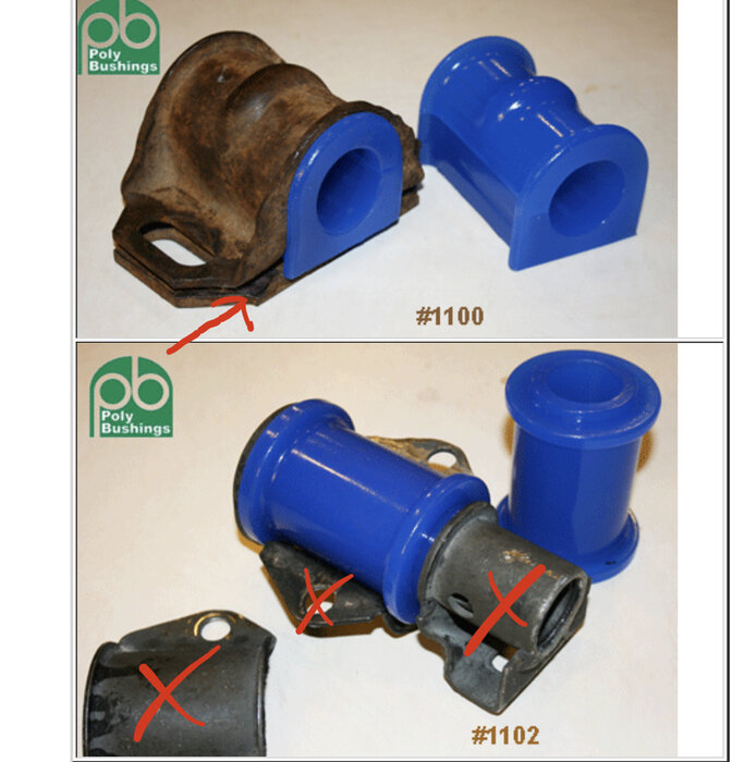

Camtron
Apr 25, 2019
2,346
1,926
US
Far as I can tell, FF have a wider pivot base plate, which I marked with the red arrow.
The parts I’m curious about are the end shells and end shaft assembly (marked with Xs) that attaches to the Torsion bar end and mounts to the lower control arm…if they’re not offering the end shaft assembly and they have not integrated it into their bar design, guys will still have a bear of a job to separate those end shafts from their old torsion bars and separating the shells, ect…
