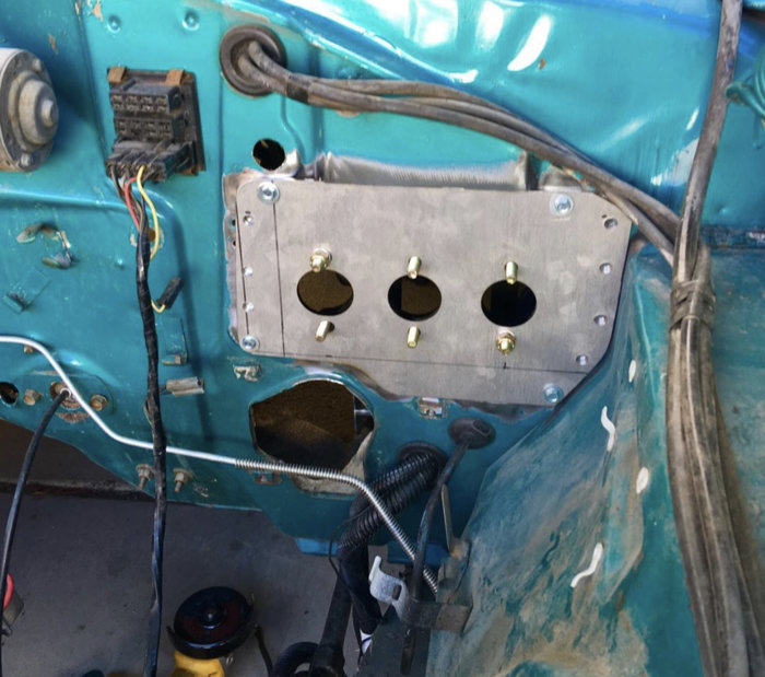

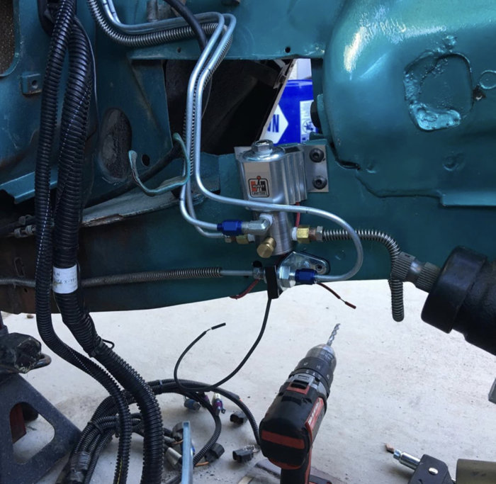

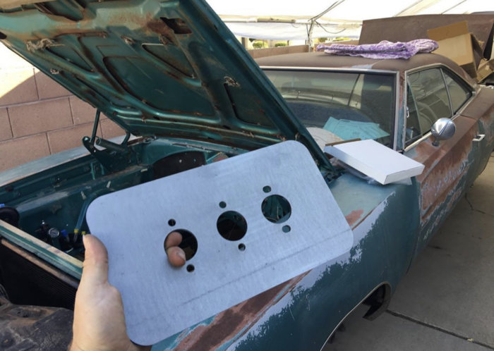

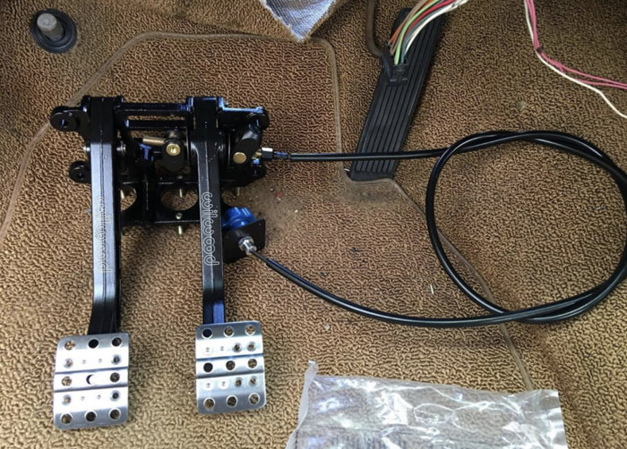

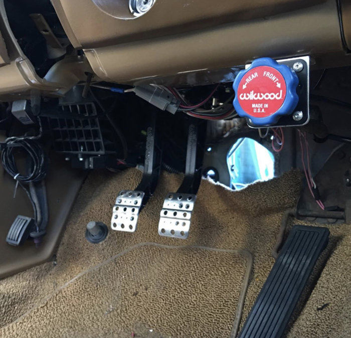

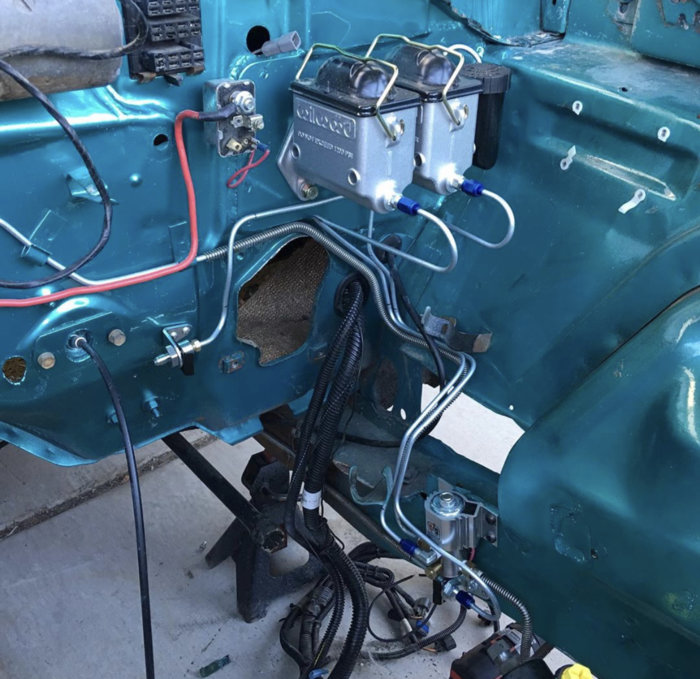

Oh, it is on the list. There’s a real nice Charger build I was watching for awhile and I’d be a liar if I didn’t say, I want to recreate it. A lot of Wilwood parts with a real nice in cab, brake bias adjustment under the dash...It’s a 3 pedal conversion too, but I won’t be going that route myself; lucky duck.
Similar to yourself, a well planned manual brake conversion has been on my mind. I only want to spend big money on brakes once lol

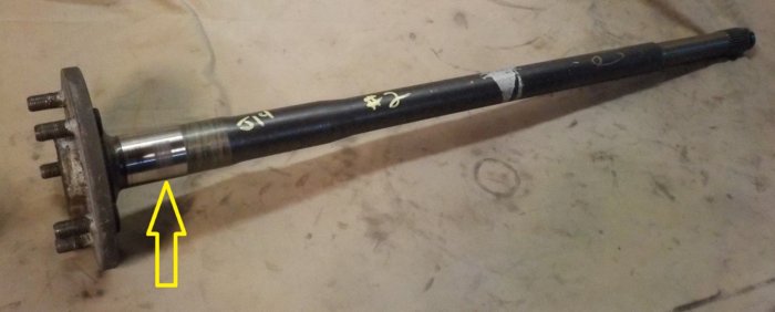

Removing the rear axles are not easy and best to be done one (1) time, so doing both repairs (limited slip and brakes) at the same time is a good game plan.
One thing to look for on the 8¼” axle shafts are the area where the wheel bearing rides at.

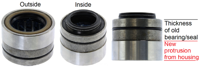

If this surface is discolored or if it will catch a fingernail then you WILL need to replace the wheel bearings while the axles are out. The good news is the axles are still useable (if damaged by the bearing) - if you use the new design of offset wheel bearing(s).
If an axle is bent, then no – time to toss (or repurpose).

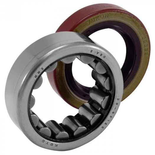

Normal (8¼”) axle bearing (and seal – which is normally a separate part).
Koyo AK1559, Centric 41368000, SKF SX4814, Timken F390 (and others)
Or the new style offset bearing
SKF R1559, Centric 41468000, Timken TRP1563TAV (and others).
Wow, three petals and neither of them which won’t help you change gears.

It looks like one of those is a cylinder for a hydraulic clutch. I'm guessing...

one pedal is a clutch...”three pedal conversion” you guys know of any car with two brake pedals? I sure don’t...that other pedal is a clutch (hence I wouldn’t be going that exact route)
