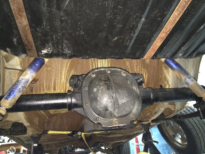

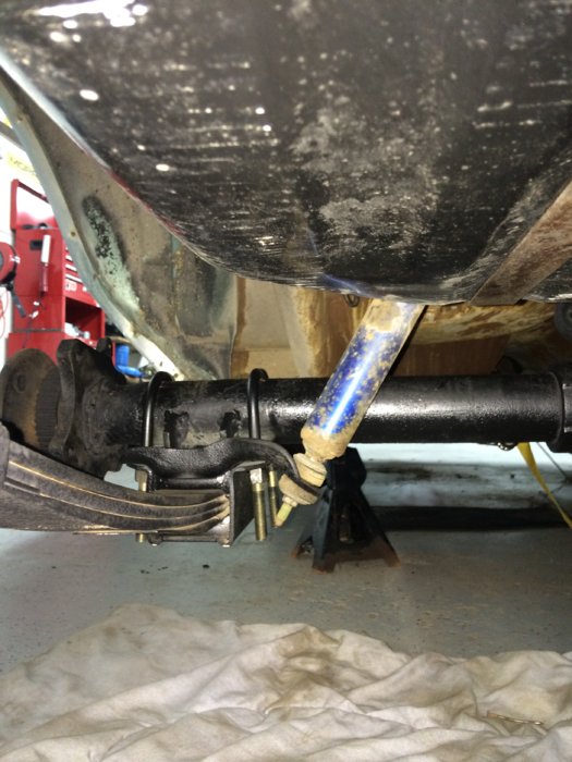

I have a 79 Aspen. I put an 8.8 in it. I didn't use an Explorer rear end though. I found that the 94-98 Mustang GT has nearly the same width rear axle. I bought mine out of a 97. I cut the coil spring perches off and welded leaf spring perched on. Its the same bold pattern and rear disc brakes. Pretty easy swap.
It doesnt seem like you had to shorten the axle or anything. And it looks like you had the ability to reuse the stock shock mounts. What are you doing about the pinion mount for the driveshaft?
