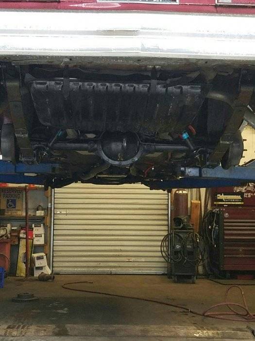

Rollin the axle and springs under.

So close, yet so far. 1.5"- 2.0" off the driveshaft should do it. Measurement from a bottom out trans yoke to the rear end is 55".

It's in. Still need to adjust the rear shoes a little.
Still a good 2 inches between the 245/60R-14's.
