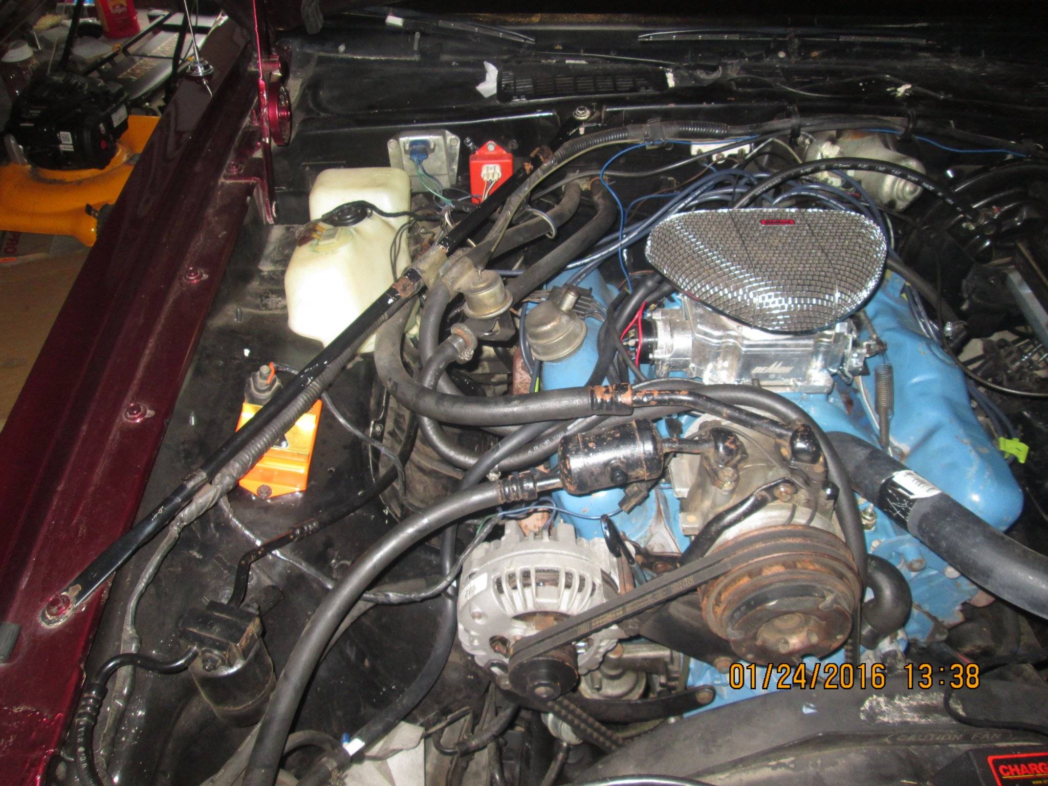

Alright gents, what's the Orange box besides the voltage regulator
Later projects brother. After this I have an 8.25 staring at me in the garage...lol.
Oh, a one inch spacer lets that box clear everything.
--- Post updated ---
Damn I hate resheathing and taping electrical wiring.
EGR timer.

It's starting to clean up. Still got some things to stow in the engine compartment. The black/red wire is the fuel pump harness, the connections by the TB is the key-on/crank trigger wire. Those spark plug wires are being replaced by Accel 8.8's.
