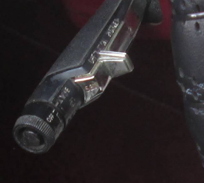

I wish I had your knowledge on the J-Bodies. I could not guess the year by the above. About all I know is the suspension is same as the F-body. Or what nit noid parts are swappable between other J's or M's. i.e. I would like to change the combo turn signal arm to a better one. I have no idea if one from a dippy, 5th ave, or imperial for example will work. My factory service manual is in bound.

Yeah, there's a notch at one end of each shaft that requires a specific orientation.
:laughing4:Im sure Cap't can post up a detailed pic of how to properly install your shaft........
