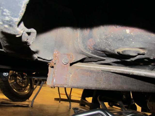

what are you guys doing for the emergency brake? my sub-frame connectors are right where my cables ran up from the rear.

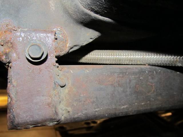

i did not do the welding, i had a local shop weld them on. after i seen there welding, i bought my welder.
the welding was cheap, free!

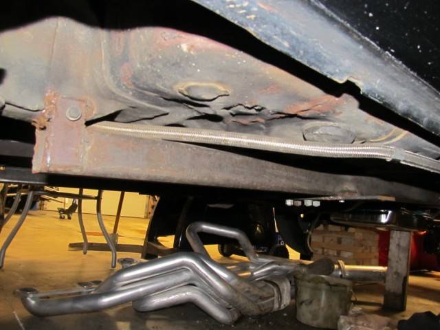

Did you ever come up with a solution for the E-brake cables? I see no replies here as to how to correct this issue. I'm also curious about this myself as I'm getting ready to order my frame connectors and would like to know what people have done about the cables. Thanks

never did get to the e brake issue yet. i've been kind of focused on putting the engine together. but i was just going to weld a piece of pipe through the connector at the proper angle and rig up an extension for the cable off the pedal. i'll have to shorten the big cable hoop from the drums but that wont be to hard.

Thanks, this is the way I was thinking of going with it but I wanted to see what everybody else had done about this issue. I guess this is the way I'll be going this route with mine. Thanks again
