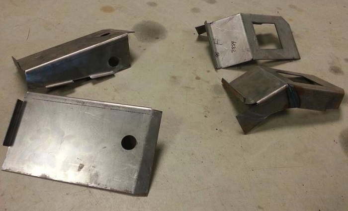

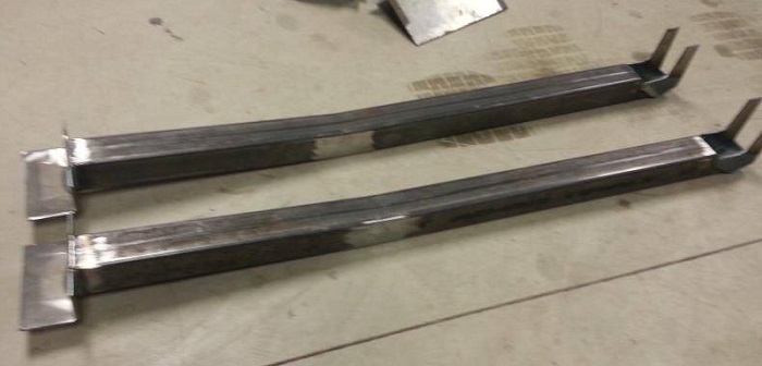

I have a set of ART subframe connectors for a 4-door. Frame connectors post #20, has better pictures of his parts (member 80 Aspen RT). This is his picture of his subframe connectors – which look exactly like mine. I also purchased their torque box set as well. All six of my pieces are still on shelf in my garage (not ready to tackle that concern, just yet).
Torque boxes.
In my opinion, for the cost of items, I just assume getting metal and making my own to get welded in. They will not look near as nice but will get the job done.
2,992
The ART stuff was crap that looked like a five year old got a hold of a plasma torch. You can make a set of ties out of $50 worth of steel from a steel supply. At the time I had mine installed I didn't have a welder or skill enough to do my own so I paid a local racer to do mine. I think it cost me $350 and he did everything.
I bought the ART subframe caps and,,,,,,,unimpressed. I ended up spending more time rebuilding them than it would have taken to start from scratch. Only reason I got them is to "save time". That plan failed miserably.:eek: I agree, looked like a 6 year old cut them out with a torch, and it was his first time using a torch, then a 5 year old welding for the first time put them together. Horrible and a waste of money (IMO)
