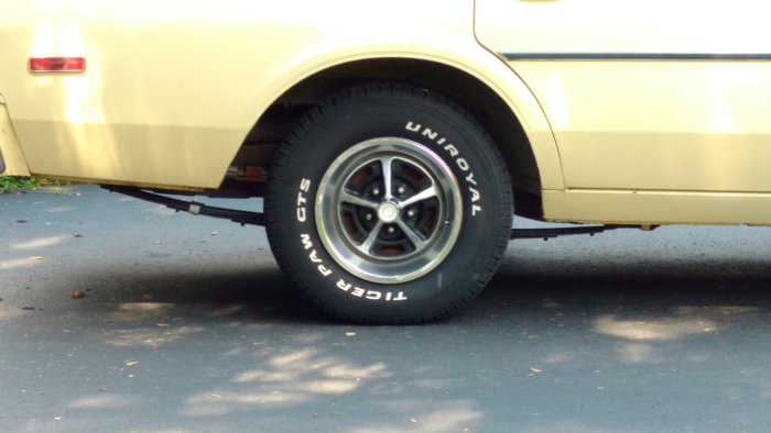

I put four new KYB Gas-Adjusts on OY a few months ago, along with new rear springs, and I am very satisfied with them. I don't think it rides too rough, although it isn't smooth as a Imperial, but I don't expect it to be. OY still had the original factory shocks on it, and they were shot. The leaf springs were basically flattened out from age and sitting. Now, it rides nicely and handles about as good as I would expect a 41 year old station wagon to handle. It's a cruiser after all. I definitely think the new rear springs also help, and I really like how it sits up just a bit now in the rear.

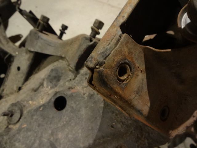

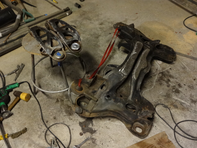

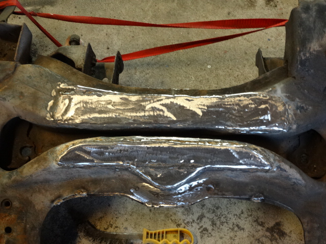

My last one I welded up I made some better skid plates but didnt close it in for some reason, I think I could of just done the center a bit looking back but I think I didnt do it full length because of the front sway bar.

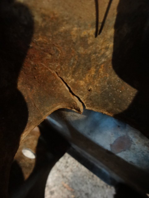

Mine had some really bad cracks in it I had to chain up and pull back to weld.

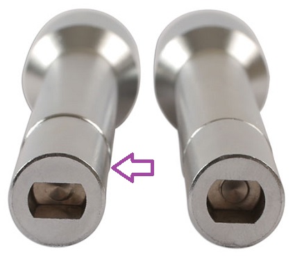

I’d like to find the “Double D socket” so I can tighten them down better.
Somehow I missed this.

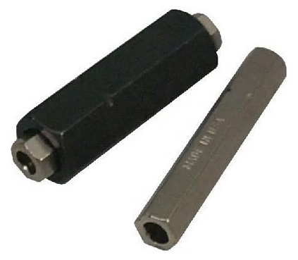

Lisle shock Absorber tool. Part number 20400
Instructions say “Place stem socket over shock stem. Hex nut socket fits the nut. Hold one, turn the other for removal. One End 9/16" and the other end .591” (15 mm)”.

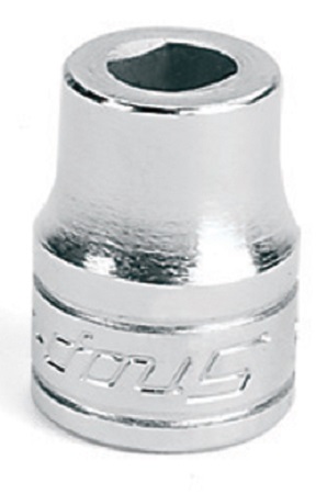

Snap-On A137 (1/4”) Note: they also make A138 (15/64”) and A139 (6 mm) – so don’t get them.

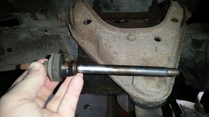

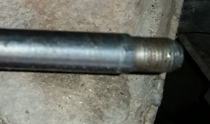

The reason I don’t recommend turning the shaft much is the shaft (front or rear) is screwed into the piston inside of the shock after getting the shock body welded (and painted). I have seen several shocks where the shaft came un-screwed from the piston (ie: shock has come apart).
The L/F shock on my ’86 came apart and was making a loud clunk noise – most likely due to improper installation (from rotating the shaft/shock and not the nut) - before I purchased the car, that is.
L/F shock
I pulled this straight up. The lower washer and bushing had worn away.
A closeup showing the threads.

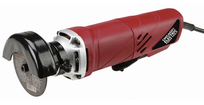

The front shock top nut is the hard one to remove, in my opinion. If the nut “looks” like the picture in post # 64 (2 posts, above) it might be easier/faster to cut the nut(s) off.
If you are considering cutting the nuts off, you need to look at what tools you have access too. If only a hacksaw, you might need to remove the upper control arm bracket (which shock attached) to cut it off after removed from car. If you leave the upper control arm attached the alignment will remain the same – but it can also get in your way (so, Pros and Cons).
A cut off saw or several other capable tools can make a quick job of that nut.
The same tool (or another capable tool) could also make quick play of the rear shock lower nut, as well.
A couple of years ago, I was at a Pull-A-Part grabbing upper control arm brackets. I didn’t have cutting tools with me, so I removed the upper bracket with shock installed and cut the shock nut off when I got home.
