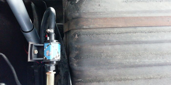

AJ seems this is how Holley worked it out too, they say those we pumps good for 400hp! But who knows, if it starts back firing and leaning out I will know pump to small!

Well got new pump in, it's like cotton wool to my ears! Didn't notice any issues with performance on my 360 but it's not like my 360 is a 500hp monster!:D
