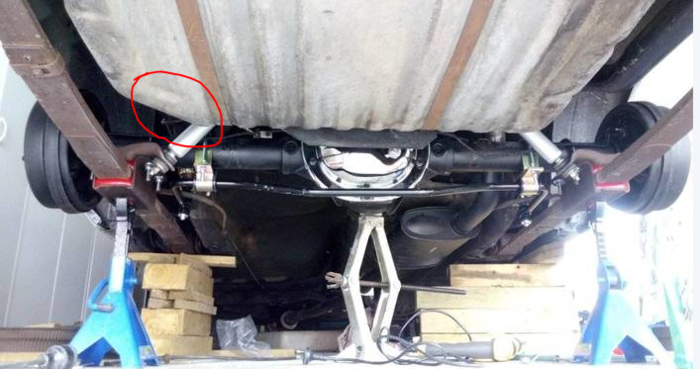

Ok this is a pic I posted before, this is what it looks like in the back end for tank placement
looks like no rib/valley for strap??

Getting back to your original question, if a person was to find a second filler neck, a person could cut off a portion of it and weld two filler necks together to get the length you need. Personally, I would use the fuller neck hose to lengthen your metal tube with. The fuel tank is not under much pressure so I would not have a problem using hose.
Now to your last question, hum, while scratching his hairy chin. I don’t recall seeing a lack of a rib, there before.
Before committing to the fuel tank move/change, there are a few options available to you.
One is use of AAR/TA Challenger side exhaust
Another is to run the drivers side exhaust over and above the differential and run both out the passenger side of fuel tank. It would still be dual exhaust but exiting out one side. I think Aspen500 has this setup.
Even another option is to run exhaust between the leaf spring and behind the rear tires. I have seen pictures of that option in our forums, as well.
I hadn’t gotten that far along yet to have any recommendations. I really like the AAR/TA size exhaust – but that is not practical on more-door cars for it tends to burn rear passenger legs on entry/exit (this is not a problem on 2-door cars).

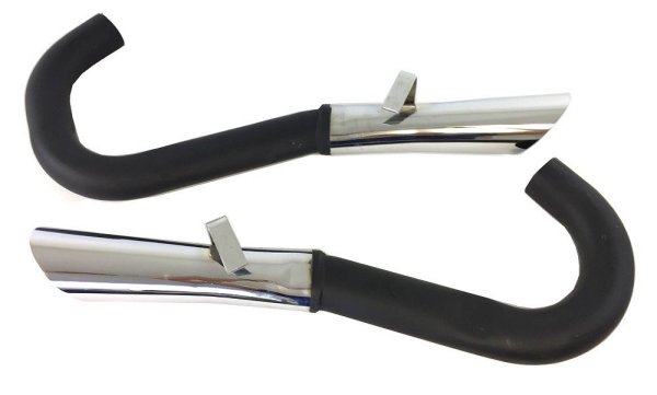

Pictures of AAR/TA exhaust system

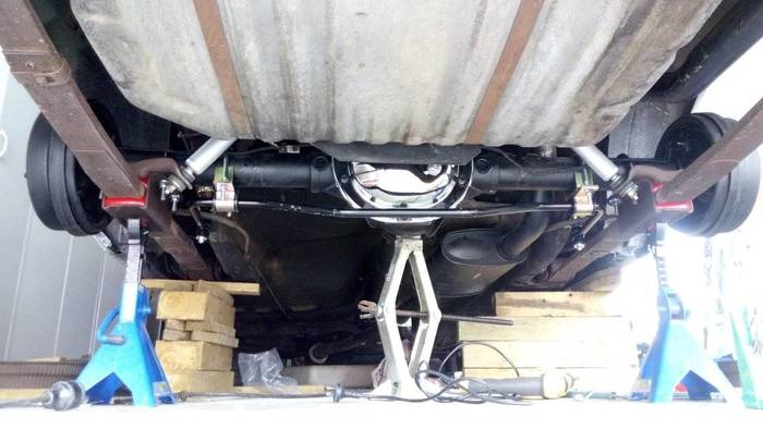

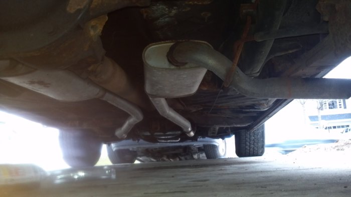

Heres how my exhaust is currently routed. It dumps out before the wheels. My only complaint is how the exit is routed causes issues whenever trying to lift the car as it doesnt allow the leaf's to really move/rotate as needed.
I'm strongly considering either moving the tank or dumping at the axle when I change setups (headers/Xpipe/possible cutouts) but I'll look into that more the closer I get to it

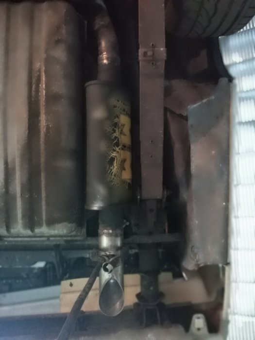

Ok have another muffler fitted, it tucks in the back between tank and leaf spring. It has Lowered sound level and given a deeper exhaust note. It seems it has dropped from 88dBa to 78dba it's hard to get exact reading as Numbers move a little when running, but that's aporox 10dba at idle. If you drove it or revved I am sure it would of been well over 95dba!!
