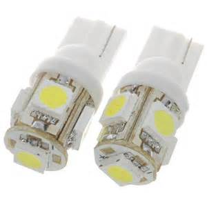

Just to add, if you go with LED bulbs, be sure to use the "COB" bulbs (see pic) where possible, at least in the cluster. They distribute the light nice. I tried the other type at first, and the cluster was blotchy with 3 bright spots and the rest was almost dark.
Some of the other pieces (HVAC, radio, etc) you have to use the "old" style, especially if it's a metal base type. The COB bulbs won't fit the opening, depending on the part and year/model of car.

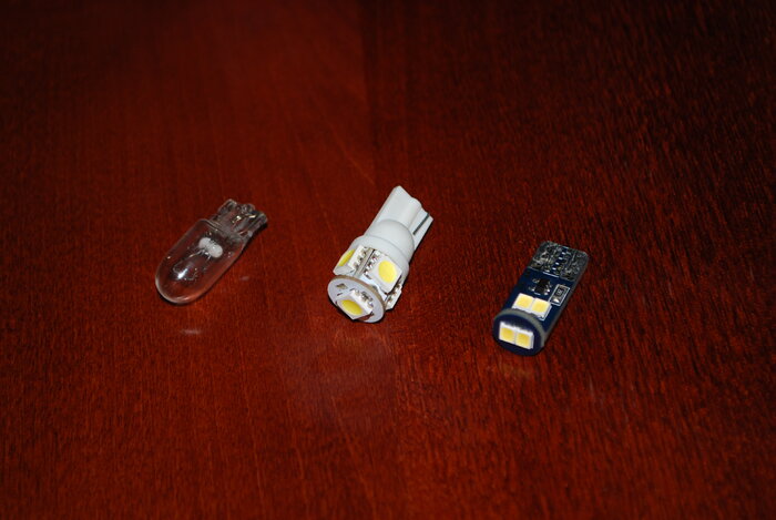

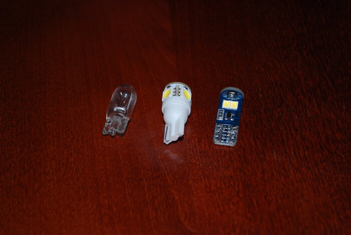

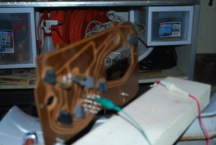

I'm having an issue trying to convert my '79 Le Baron's dash lights from 194 incandescent bulbs to LED.

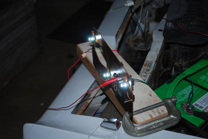

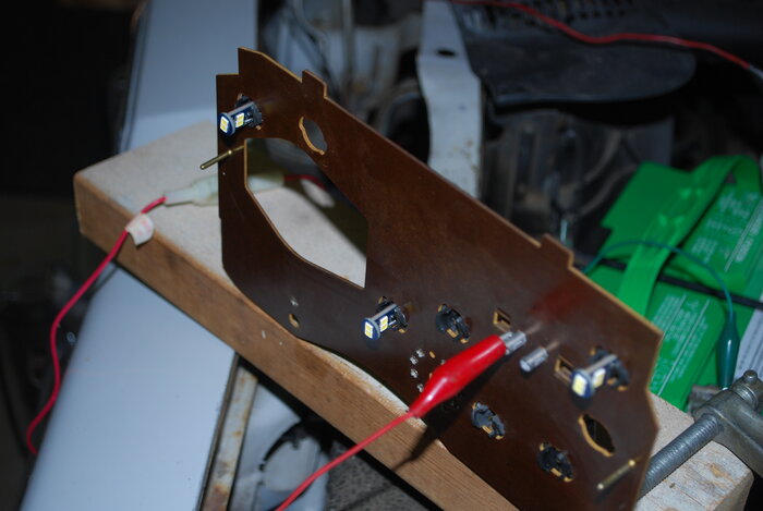

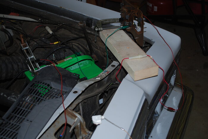

So the white LED (center) seems to work fine in all of the 194 sockets. The problem is that style's diameter is to big to fit into the metal tubular opening on the back of the headlight, wiper and possibly the ash tray light. This caused me to buy a different LED with a smaller diameter to fit into those particular locations. Here's the real head scratcher: When I inserted the newer LED (far right) into the socket for the headlight switch, connected a ground to the socket and put power to the LED, it blew the 3 amp fuse for that circuit! The 194 and the white LED (center) does NOT blow the fuse for the circuit. I bought a package of 10 of each LED. Thinking that perhaps the newer LED was defective, I tried another LED and blew the fuse once again! I replaced the fuse and tried another white LED (center) and it worked. I disconnected the power at the battery and installed a a 3rd newer LED and blew the fuse again! I removed what is called the "right hand circuit board" (the one behind the speedometer and fuel gauges) and rigged up a test to see if I could get the newer bulb(s) to light. I put a switch in the line and a fusible link with a 3 amp fuse. The lights work. Here's pics of my set-up.

Why does the fuse only blow with the newer (far right) LED but not the other LED (center)?
when I'm saying far right and center I'm referring to first pics of the 3 different lights.
