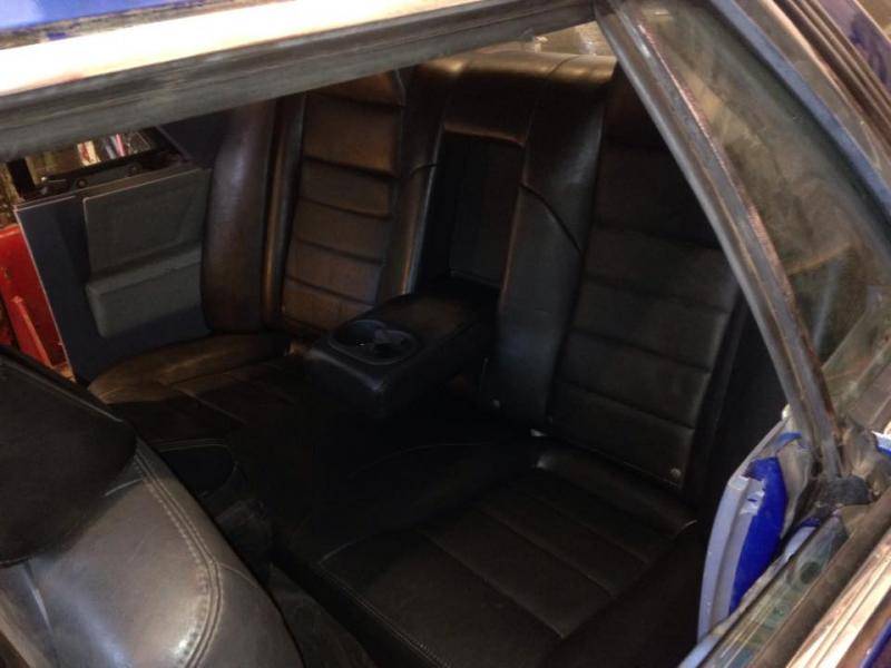

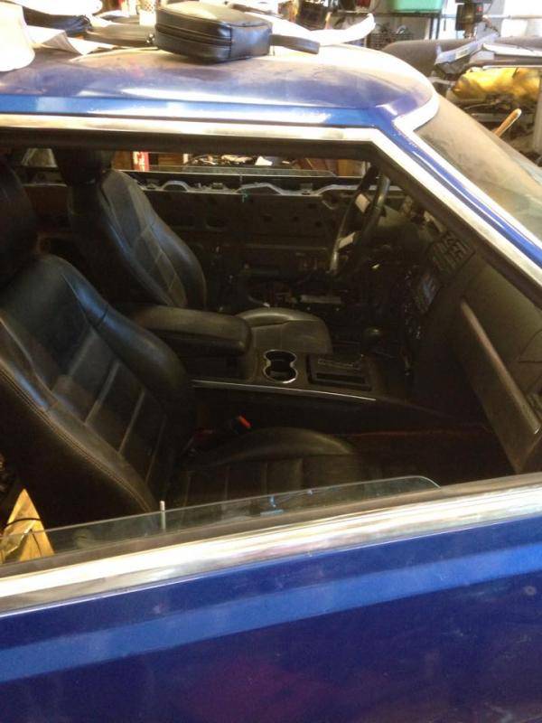

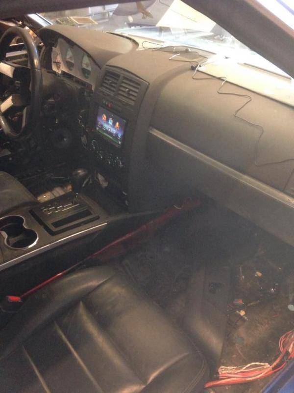

A few more interior progress pics. It shouldn't be long now! Hopefully I'll be ready for Carlisle.

My biggest challenge was that I wanted to use the engine and trans, keep the computer controls, and not cut up the car in the process. I couldn't use conversion mounts on the stock K-frame without serious modification to the firewall and tunnel. This way, everything I added can be easily removed in the future. I did the same with the rest of the car. All of the Charger interior, HVAC and other parts I used were modified to fit the Mirada, not the other way around. It made for quite a challenge, but I think it was worth the hassle.
